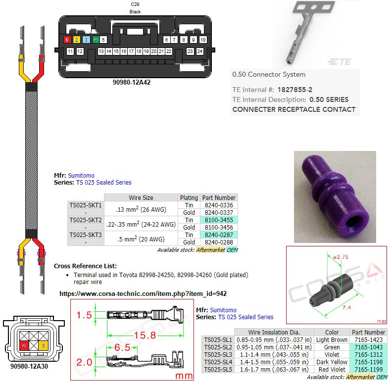

    You could use a dual cable from door handle to the Certification ECU. 2 sealed terminals at the door connector and 2 at the CECU.

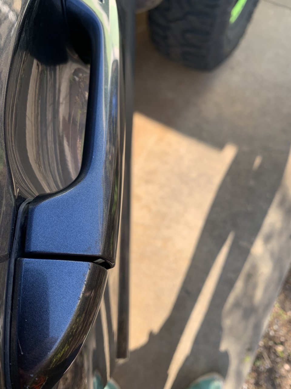

    Dudes. I’ve done a lot of stuff to my truck over the past six years. This was by far the biggest pain in the ass. I swear it took me at least an hour to get the handle back in. I couldn’t figure it out and ended up removing the entire housing to figure out how it went back together. I had to reach inside the door and compress the metal hinge thing while sliding the handle in. Still super finicky.
    I also broke the tab on the piece that screws in when I tried to gracefully catch it with my foot and stomped on it instead. So while the jb weld was drying I decided to reassemble everything. Got it all out back together. Put all of the tools away and decided to jiggle the handle. It popped out and I had to start over. :annoyed:
    Oh and I don’t know what I did but if I release the handle slowly it doesn’t return all the way and I have to push the handle in. Tried adding some triflow while it was installed but it didn’t help.

    Oooooooh….I read that post and didn’t know what it was. Now that I’ve installed mine I know exactly what you mean. I spent so much time trying to figure that out. Your way worked better than mine though. I had to reach inside the door for my method.
    Also that stuff that holds the plastic sheet on. Yours is nice. Mine was in the sun and hot. Huuuuuge mess peeling that off.

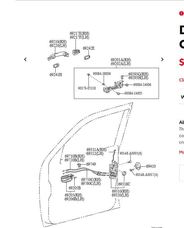

    When I look for the part number on the first page, all the part websites say it's for the right hand side handle. I thought I was trying to get the left side handle and then flip it to use it on the right. Correct? I'm looking for the MGM handle (69210-0E080-B2). Is that still the right P/N?

    I just checked and the part number you listed is the exact one I ordered for my MGM a couple years ago and it worked perfectly. I would imagine it would still work.
