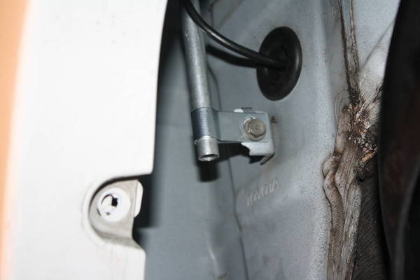

    I have seen one case where the seal around the Antenna leaked.
    This might be a thing to look at?
    I’m NOT talking out the outside seal.
    https://www.tacomaworld.com/threads/how-to-replace-oem-antenna-in-fender.261341/

    Much appreciated! I should have said there was water, but has since dried up and there was no new water after the most recent rainfall. I’ll have to check the mast.

    Don't forget the grommet for the antenna wire.
