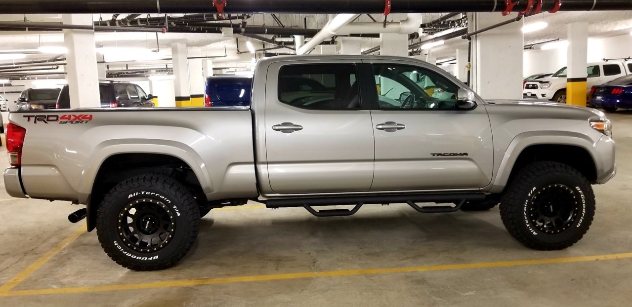

    2016 tacoma trd sport
    2.5 lift 33 tires w/ method rims
    Rear passenger wheel won't unlock.. didn't have the ebrake on tried 4hi 4Lo happened last year locked when I was driving almost went into the ditch Toyota said nothing is wrong with my truck and they can't recreate the problem
