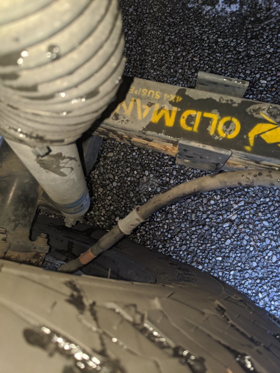

    Not to mention it is only the right rear wheel left is fine and has never seized

    It may look fine, but if it got stretched it could collapse and cause fluid not to flow properly. When I lifted mine, I made a lift block to raise T that is mounted to axle to avoid this, instead of installing extended brake line there.

    Are you able to tell whether the shoes are actually engaged and holding tight against the drum and not releasing? At least that would tell you if it is a hydraulic problem or not. When I had my issue, when brake was applied pressure caused the brakes to engage (tighter every time you pumped) but when I let off, the trash would seal from back pressure and keep pressure on that wheel. I am in Louisiana so no freeze problems but I feel your pain - I have way less hair than I used to before all that happened. Pulled most of it out!
    Edit: That hose doesn’t look right to me. Does it look a little swollen as it goes away from the wheel towards the frame. Could be the pic but does it bulge a little?

    Yeah I'm not sure I'm not very good with auto work haha but I do know it did it before I put the lift in as well Toyota has been giving me the run around for about 1.5 years regarding it.. still hasn't unlocked waiting to hear back from toyota to try and get it towed to the shop and looked at

    350$ at Toyota 50$ Tow and this was the ultimate verdict. "Right rear side break shoes get seized due to water and temperatures below 0degrees"
