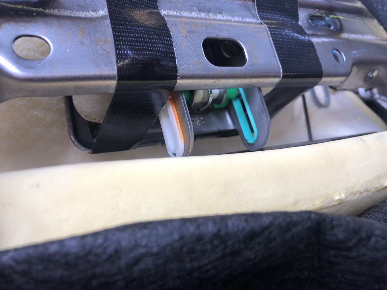

    Thanks for that! Wouldn’t haven thought that, Now I have a bette idea for what to look for.

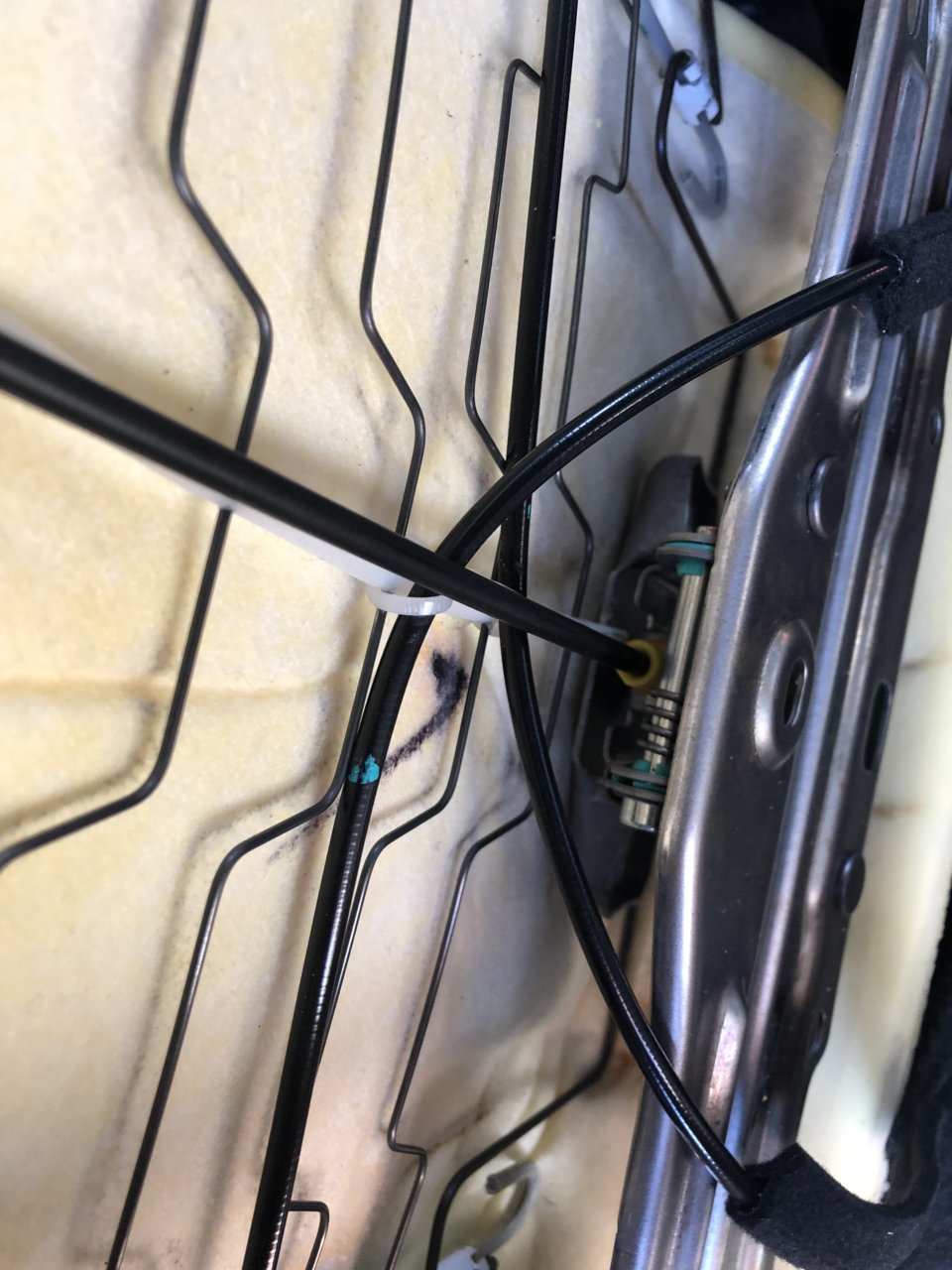

    Well I think I have resolved this. A few days driving and I no longer have the “thus” in the back of my seat.
    I removed the rear seat backing and identified the headrest restraint. It’s a funky metal bracket on a hinge. It definitely had some play and that’s exactly what I was feeling when braking hard. I put some tape holding it in the back position and all is well so far:D
