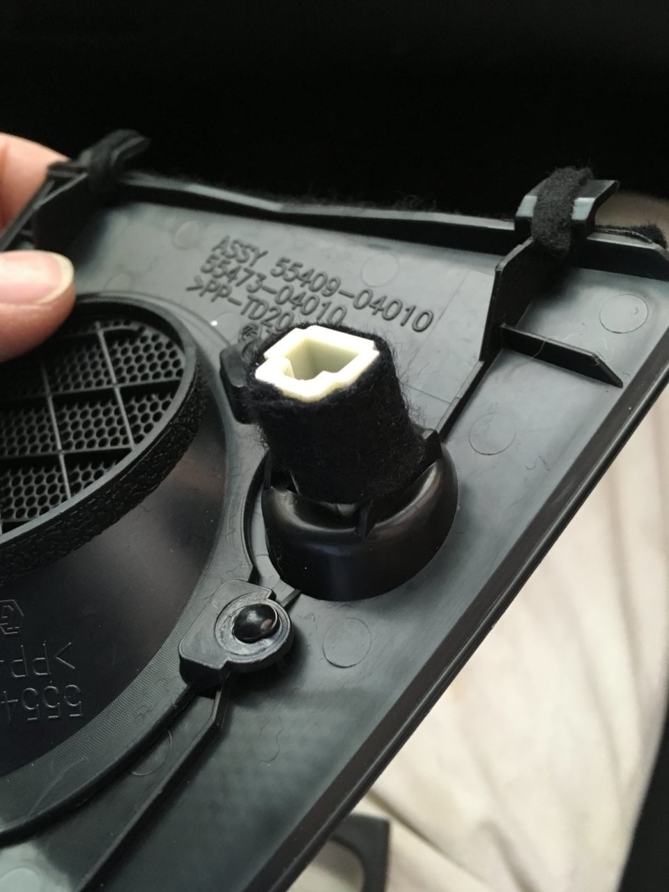

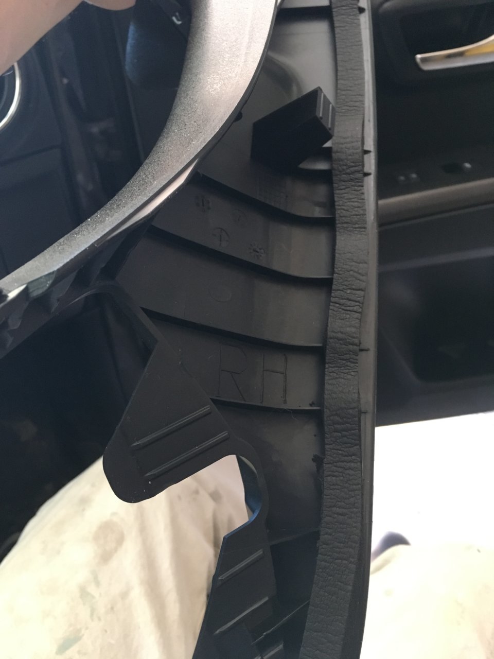

    Got home and put it all back together and redid the foam strip along the APillar cover, put felt tape down where the tweeter bolts down, put felt tape where the light sensor clips in on the top side of cover and wrapped the light sensor plug. I noticed the sound of clipping in the sensor was strangely the same as the ticking noise we’re all hearing and the space the sensor plug fits when the cover goes back is very tight so we could be hearing it vibrate around in that space, so wrapping it with the felt tape took out any space in the fitment when the cover is in place. Cross my fingers!

    After felt taping yesterday and the long cold drive in to work, no ticking noises.

    Same noise started on my '18 a few months ago. I just took the a-pillar trim off for the time being since it was driving me crazy. Saw this thread week or so ago and decided to give the felt a try. Stopped in at the local Michael's craft store and bought a sheet of adhesive backed felt for like $1.04. Applied it to the tabs mentioned and no more squeak.
    That being said, I think the fix was more than just the felt. After I put the panel back on I made sure the tabs engaged the designated slots in the dash. Once everything was properly positioned and secured, I notice that the gap between the trim and the speaker grill was about half of what it was before I took the panel off. So I'm thinking that the trim was installed improperly from the factory in the first place and that was applying unnecessary pressure to the tabs.

    In summer 2018 I had placed adhesive foam rubber padding on the A pillar plastic, as many have in this thread. It turns out that didn't work.
    I began hearing that stupid noise a month ago when temps dipped below 50F. This go around I opted for felt with an adhesive back. It cost all of $1.95 for a large rectangle from a crafts store. You just cut segments and trim to fit the angles. It's been quiet ever since.
    I highly recommend going the adhesive felt route first.
