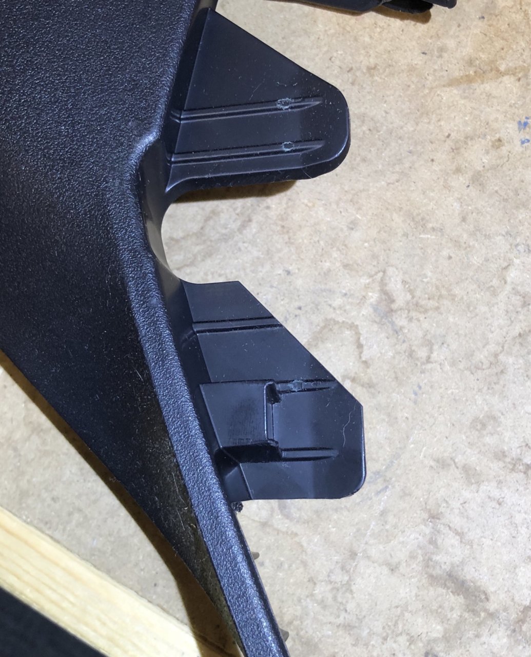

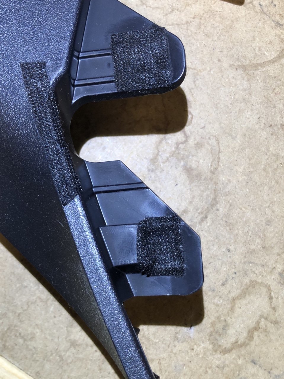

    Keep in mind, I made sure to add felt and wrap around corners anywhere plastic met plastic. You just have to pay attention to the tabs that need to seat into the dash/pillar. Those tabs can't take too much felt or the pieces won't snap back in due to lack of clearance, so don't wrap around the tabs.
    Hope this helps you out.
    1. This was my first attempt using adhesive foam that was suggested by someone in this or another similar thread. It was meh, but I left it in.
      • [​IMG]
    2. I then moved on to adhesive felt, and that did the trick
      • A-pillar:
        • [​IMG] [​IMG]

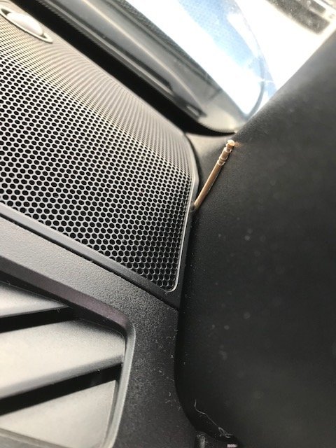

    I found this solution from a similar 2017 thread. Obvy have to clean it up, but worked perfectly...no more rattle! it was killing me!

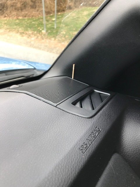

    ROBERT
    The toothpick trick works!!! It ain't purdy but it allows you to keep your sanity until you can fix a permanent solution. Use a thick pick to apply as much pressure between the grill and A-pillar cover as it takes to stop the rattle.

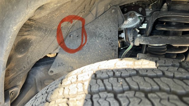

    F Me! I have been pulling the dash apart putting toothpicks and Tesa tape all around the A pillar and speaker cover and could not get rid of this maddening rattle. I spent two weeks and rode around for days with everything pulled apart and still could not fix this. Then I found this fastener in the passenger front wheel well had come loose. I was going insane but that solved my issue.
