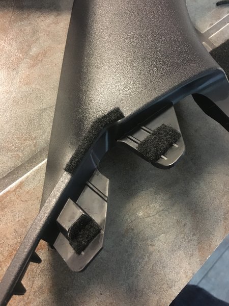

    Pulled mine off today. You can tell where there is excessive wear and tear. Bought some velcro from Walmart, hopefully that will do the trick.
