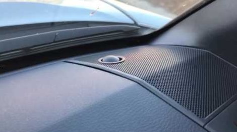

    Question, what's the round plastic push clip on the speaker cover for? Clipped in, mine was loose, so I added mole skin to the clips and reseated.

    Not sure which round push clip you're talking about. The only round thing on the cover is the light sensor that actuates your DRL and light dimming functions.

    It's the round part in the pic. I was thinking a tweeter for the higher end model.

    isn't that the light sensor for the auto headlights?
