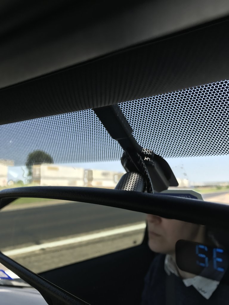

    I was having the exact same noise but it was actually the wire cover on the review mirror. I loosened it slightly and the sound is gone permanently. Several people including a Toyota tech riding shotgun said it was coming from the center of the dash despite the fact I swore it was coming from the passengaer speaker cover. Just saying if you're having this issue, you may try this before pulling your dash apart.

    Curious if that mirror wire really was the source of your rattle. I think this is my next step. My rattle sure sounds like it's coming from the climate control area or maybe cup holder area. That wire you identified will be super easy to check so I'll give it a shot. Thanks for the suggestion. You said you loosened it? Was it the wire casing contacting the mirror or were the wires loose inside the casing? Thanks.
