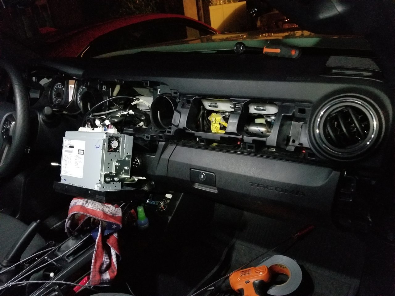

    Pulled apart my dash and found a working harness mounted to a stand with a loose washer. Taped it up and so far so good, but once again still sceptical. I did paint my trim red though since I had it off.
    I also did notice a lot of loose foam tape that is used on the vents. I made sure they were nice and tight as well.

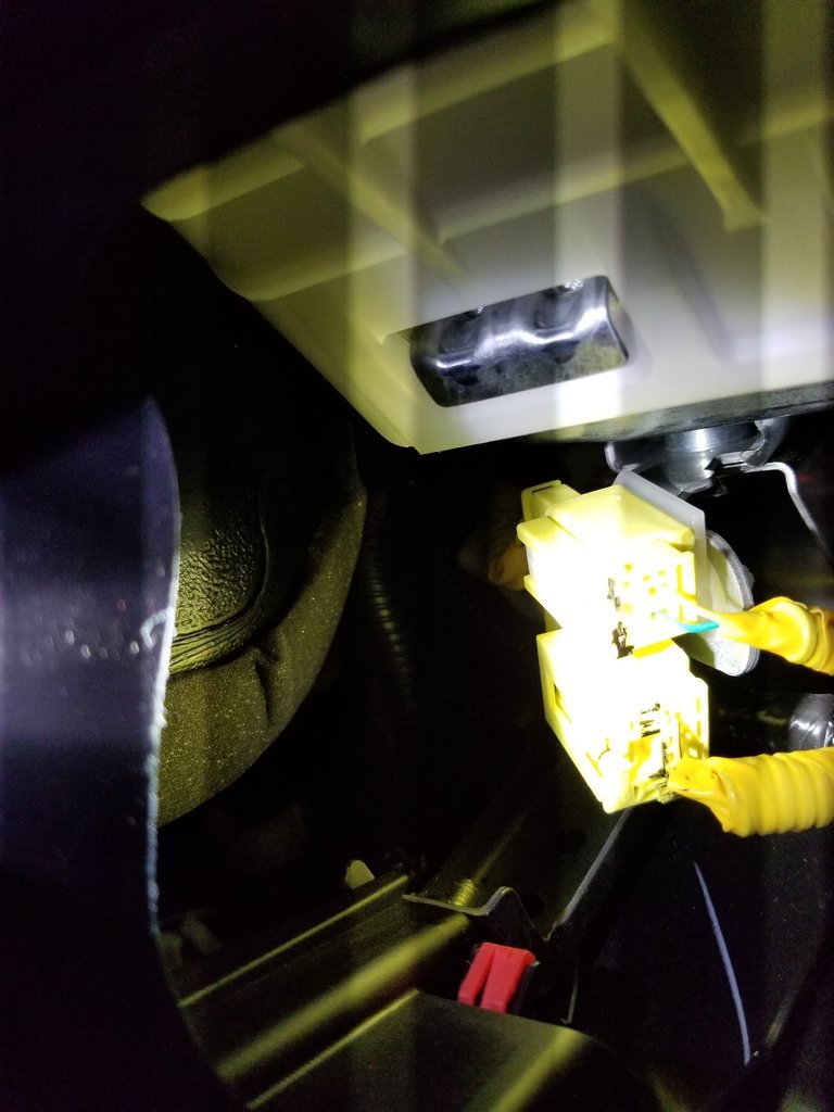

    IMHO this yellow plug is the real culprit cause I did the dash fix and the airbag fix and kick panel fix and it still rattled.
    So I took apart everything and went for a drive to see what was rattling and this plug had washers that are loose. Taped those down and no issues so far. Also there was a a lot of loose foam insulation so I made sure to rub them down so they would stick.
    Hit me up if you need help taking apart the dash.
