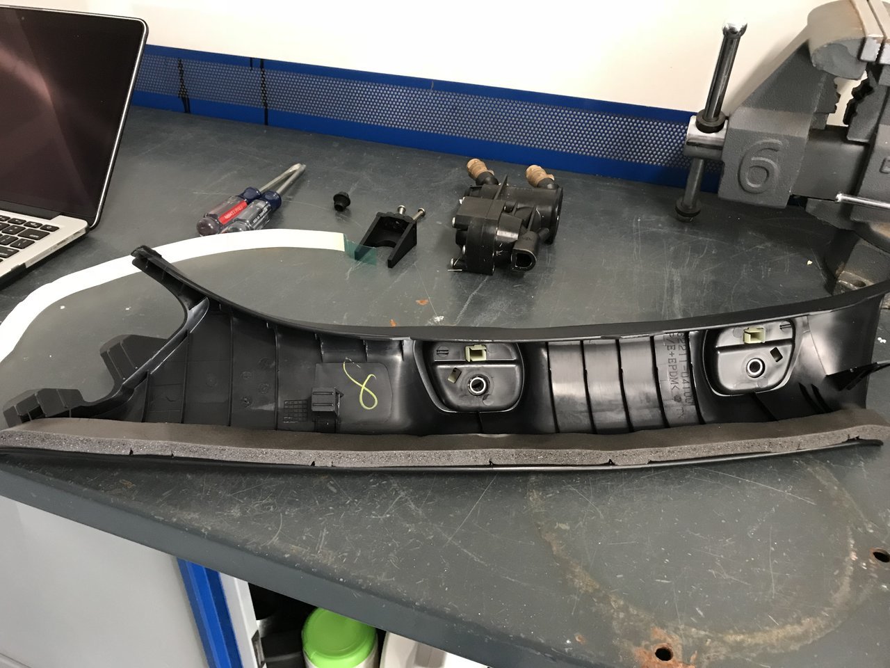

    I'm so glad I found this thread. That rattle has been driving me nuts for about two months now. After reading through this entire thread, I agree that the problem seems to be with the foam tape installed on the inner side of the passenger A-Pillar. Specifically because the Toyota-installed tape is simply placed up and over the little plastic ribs on the trim piece. This allows a portion of the tape to not adhere to the trim and is likely the cause of the noise. Here is the solution I used to fix it which I think is very simple.

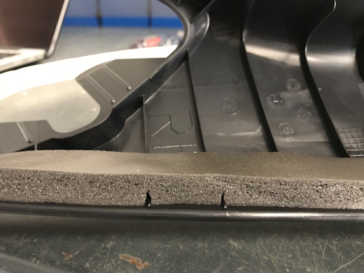

    Once you have removed the A-Pillar trim, completely remove the foam tape installed by Toyota. Then, using a brand new piece of foam weatherstrip tape (I used 3/4" x 7/16" rubber foam weatherstrip tape from Home Depot $4.18), lay the strip along the entire length of the trim piece but DO NOT stick it down yet. At each rib, cut a slit in the foam tape to allow the tape to sit completely against the main part of the trim piece. Once you have cut slits for each rib, now stick the tape firmly to the trim piece and reinstall it in the truck. Hopefully the pictures below better illustrate what I'm babbling about.
    So far, I've only taken it for a test drive in 60 degree temps, but the sound that has annoyed me for months is gone. I'll update if the sound returns on a colder morning. Thanks for all the insight guys, this sound has been making me crazy.

    I have had this problem for over a year. Toyota replaced the speaker gasket/cover, but the problem returned about a month later. I've shown this thread to them. Today I was able to repro the issue with the service manager in the passenger seat, and so they are trying some adhesive-backed felt between the pieces that are rattling. I'll know whether or not the fix was good the morning when it gets cold again.

    I did this and it completely fixed the issue. Thanks!

    I can confirm that this fixed the issue for me. Two and a half months of winter cold (as cold as it gets in NC anyways) and there has been zero rattle.
