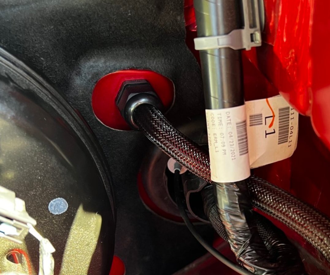

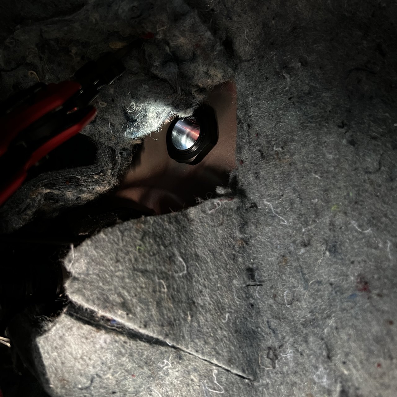

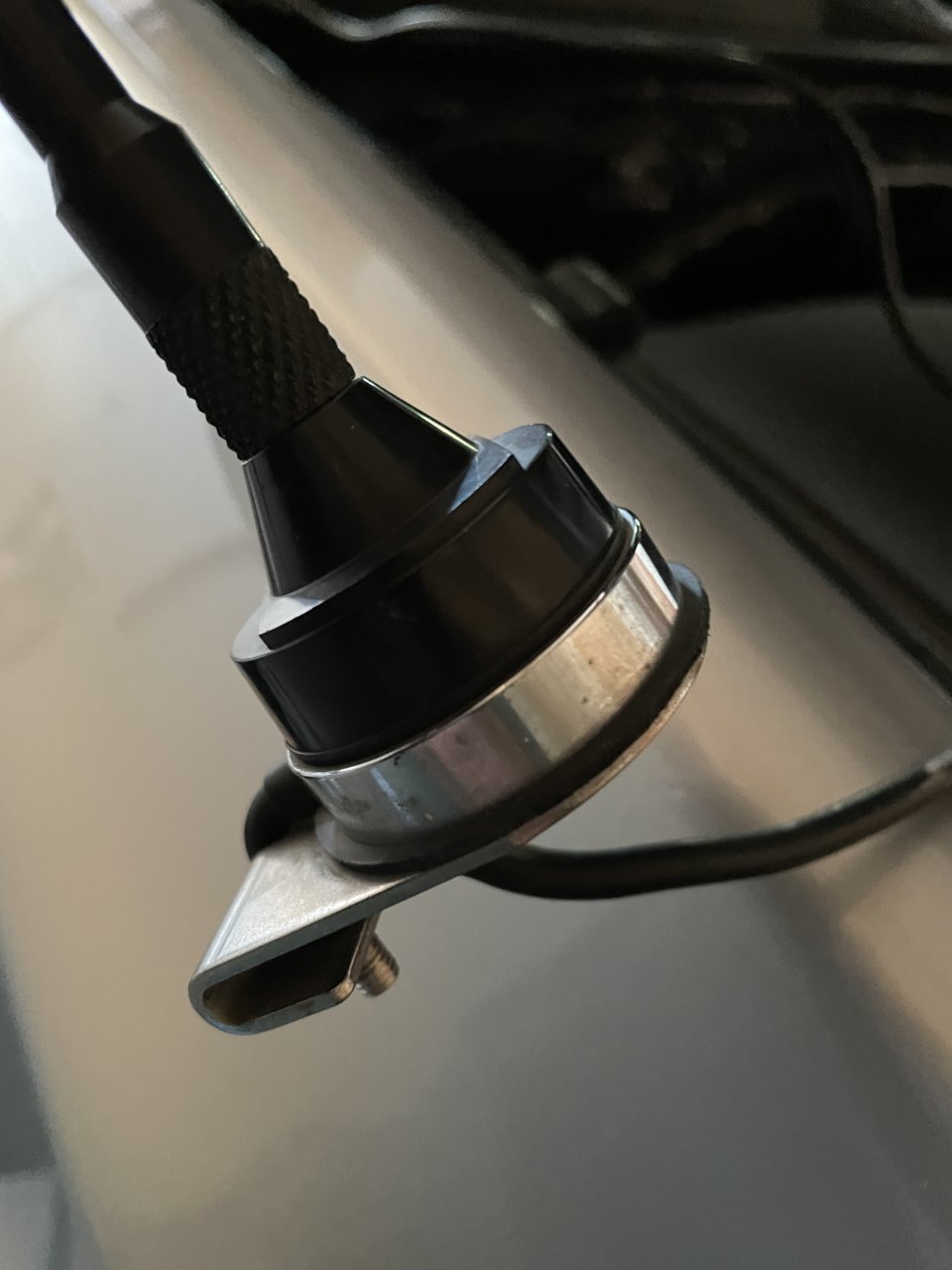

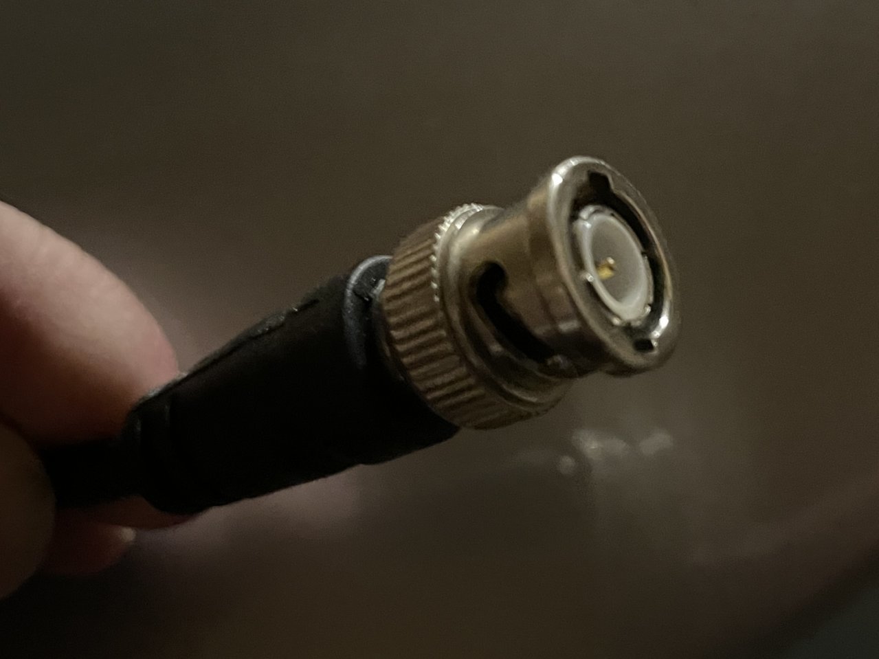

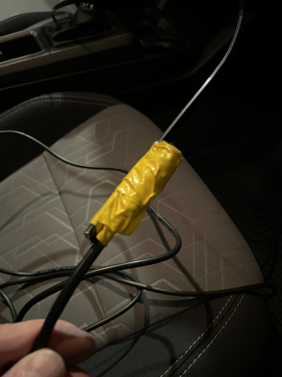

    I have an antenna I want to attach to the hood and the coax to go through the passenger side firewall.
    I see an electrical loom that goes to the kick-panel on the passenger side. I cut-off one of the nipples, but the hole still isn't big enough to pass the connector through.
    Should I be taking the whole large grommet off to trim it better? That looks like a bear to remove and replace...
    Have I missed something obvious? Thanks

    Stick a coat hanger through and then electrical tape to the wire and where the connector is at the hanger put electrical tape to where it tapers down and just pull it through it will stretch

    You could always use a little bit of Vaseline to help

    I’ve always run just the cable thru the firewall, and then crimped or soldered the connector on inside the cab. Allows a smaller grommet hole to be used.

    good to know regarding the stretching - maybe I'll add a cone of cardboard to it so that it's not a blunt end that's trying to be pulled through (I certainly couldn't push it, however much force I used)

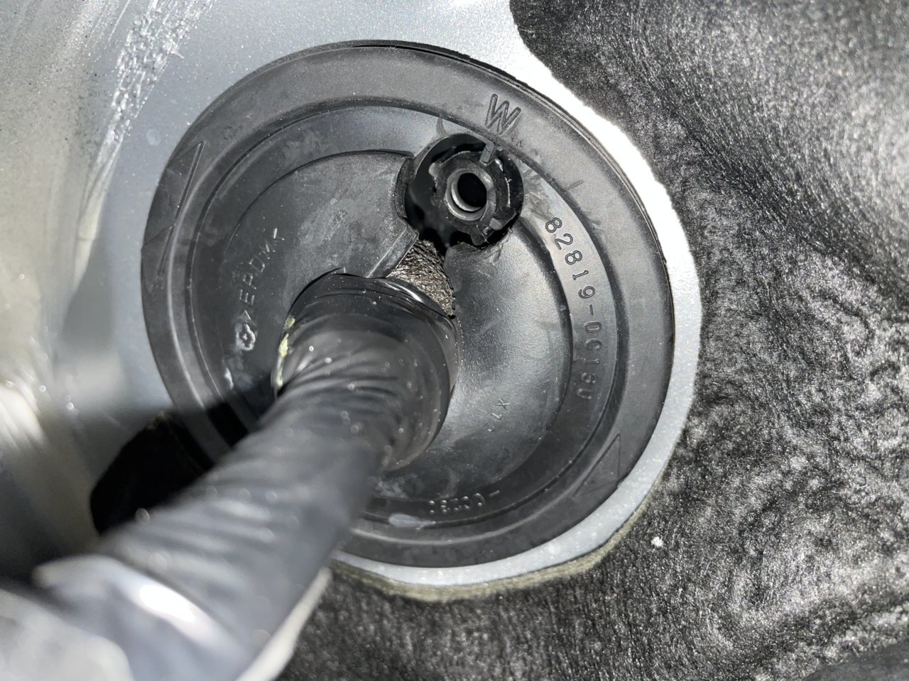

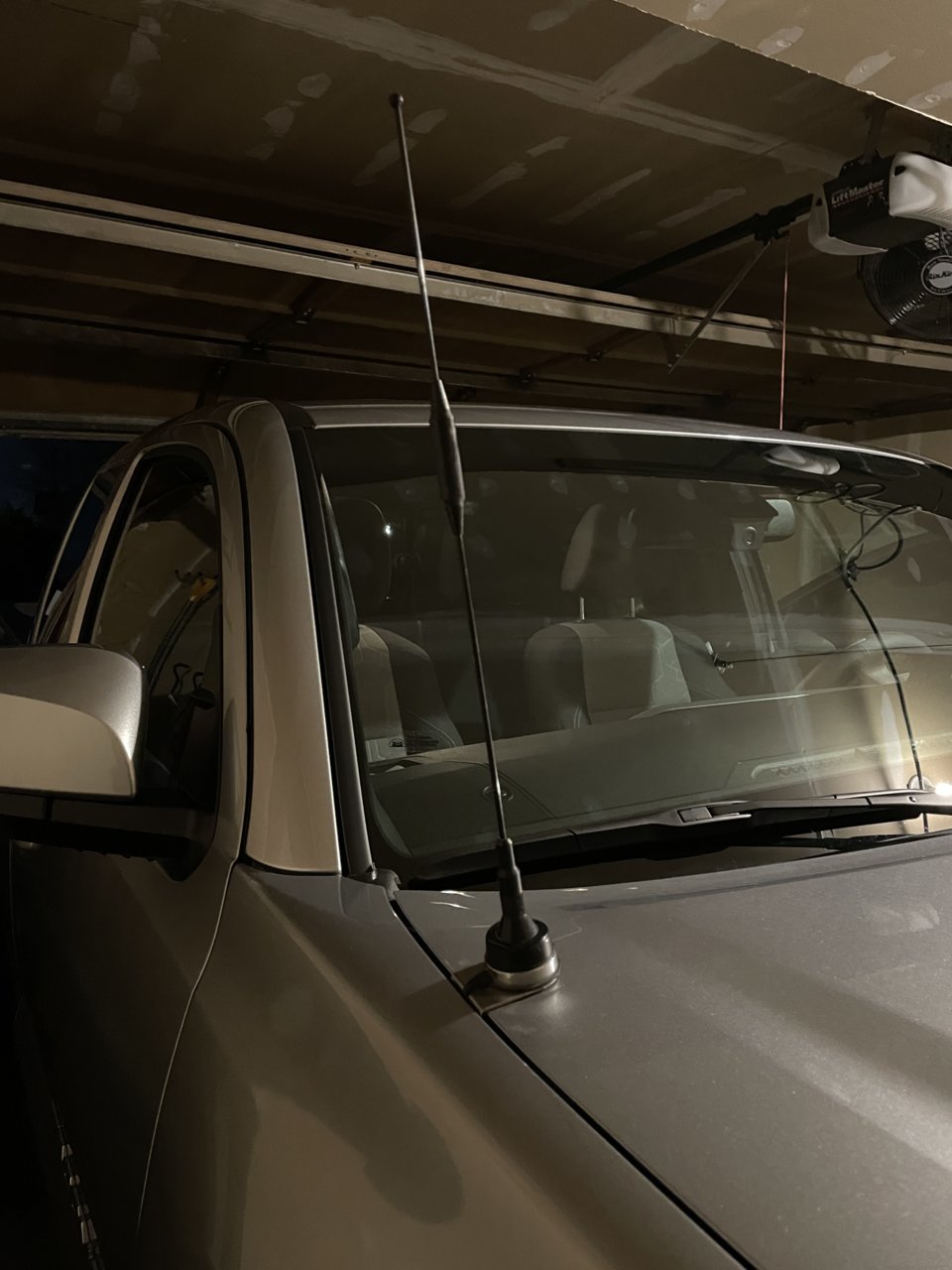

    pulled it through with a long piece of plastic I had - had to use pliers and really pull hard, but it went through successfully and the rubber grommet is nice and snug against the wire.
    I might move it back towards the cab later so it's more upright, but at least it's been attached successfully.
    Thanks for all the pointers!

    Just for future reference in case any sees this. The easiest spot to run wiring on the passenger side is the through the AC vent drain hose grommet. It's easily accessible from the cab and is a decent size. Also, will not interfere with the drain hose.

    Damn and no cutting. If I get interference I’ll re-route otherwise leave as is. Thanks.

    They do have replacement bnc connectors that can be soldered or crimped on with the proper tool so you only need such a large hole. Most shops that sell/install audio systems for vehicles can do it.
