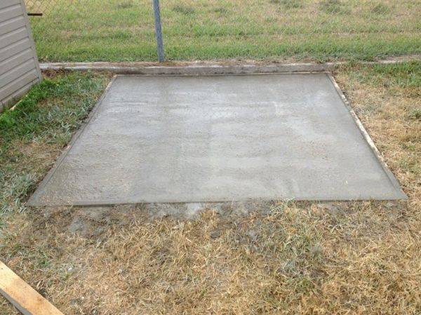

    Well...I screwed myself pretty solid. The wife likes the look of the slab for the shed:[​IMG]

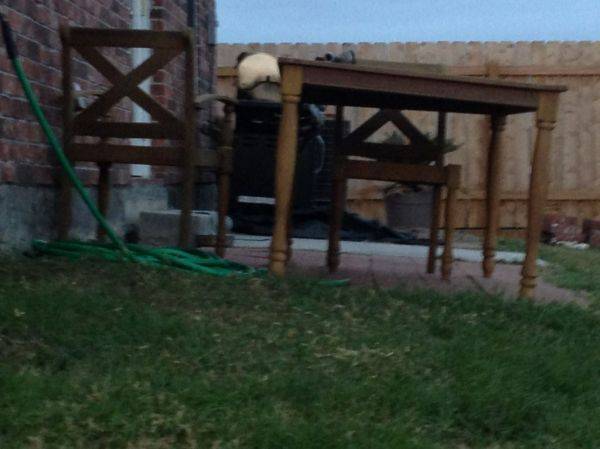

    and therefore wants to fix the patio out back. She wants to plant some stuff out there and be able to put out the new dog house.

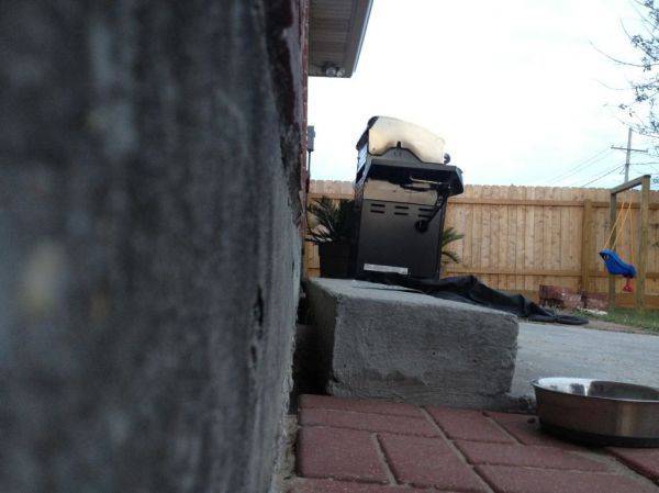

    I'm pretty set on how to do the pavers but my question is how to fix the step. There is a slab 85"x84" and the step is part of that slab. The subsiding soil has tipped/slanted the slab away from the house a bit:
    I can pull up and level the rest of the patio- but that slab is 2000lbs of concrete at least....Any ideas?? I can take any other photos that'll help...
    Right now I've kicked around cutting the step apart from the slab, leveling the step and then covering the slab. Wife wants to just brick over the whole step...Not sure how.

    What about mudjacking or slabjacking? I'm not an expert on it, but I've heard it can be about half the cost of having new concrete poured. (Like most things, I'm sure cost varies by what part of the country you're in and how "complicated" the job is.)

    I'd demo everything out to do it right.
    Looks like you have some wicked slope, there. I'd go 1/4" to the foot max.
    A nice, compacted, properly graded sand pad is what you need before a single paver hits the ground.
    You build the step out of pavers to match the field. You will need a rich sand mix or mortar mix to bond (lock in) the pavers for the step or it will fall apart with traffic. If done right, you do not see the mix.
    A staked perimeter frame is necessary or the pavers will creep/spread and the job will start looking ugly.
    Your paver supplier should be able to fill in the blanks, if any.

    The grade is what is killing you. At one point its likely that step was nice and level with the house but its dangerous now. Dont just cover it up with stone.
    I would address the grade issue first. Like was mentioned removing this slab is the right way to do it. Then you can lay your pavers on a bed of crusher dust that has been leveled and tamped. I worked in Landscape construction for 6 years as the carpenter and 60% of the work went into the foundations of our jobs.
    You cant cover a broken leg with a band aid.
    If a deck is not entirely out of the question (according to the boss), you can demo the step and put in a nice level, clean looking structure that will cover the mess that is there now. And you will be able to set hotdogs on that table without fear of them rolling onto the ground!

    Rip it all out and start from scratch. You will thank yourself later. You'll spend more time and effort trying to make that work than you would just tearing it all out.
    A patio would look much better and probably cost similar to the price of a deck if you install the patio yourself.
