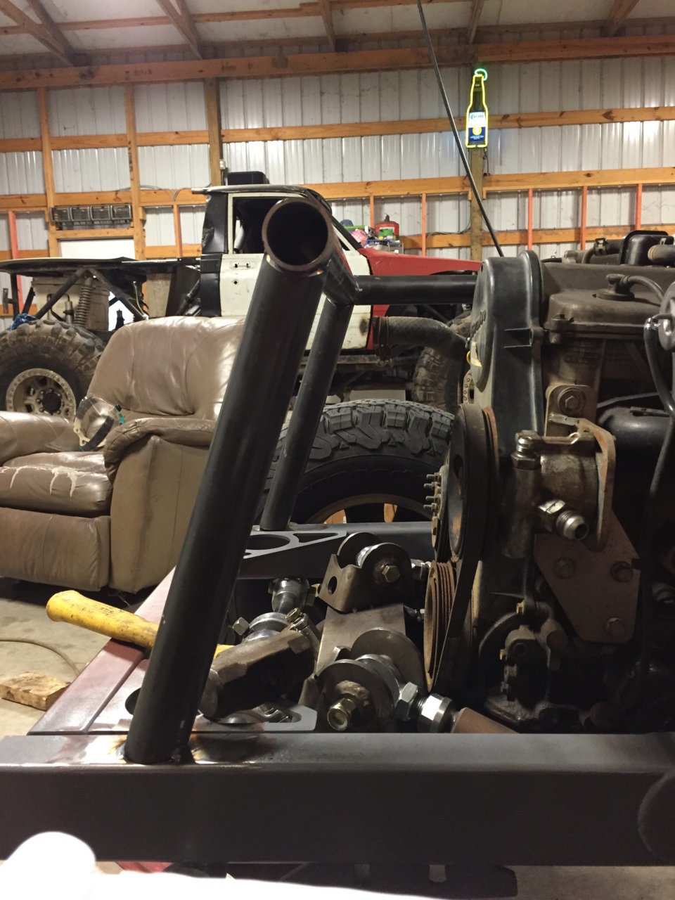

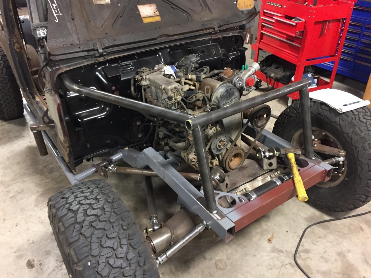

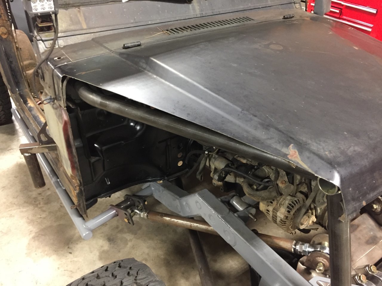

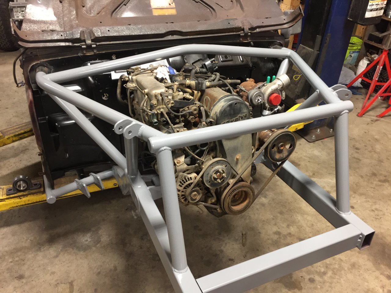

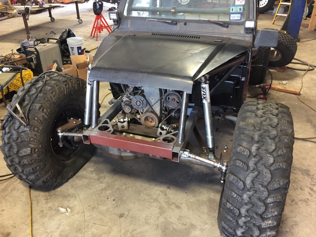

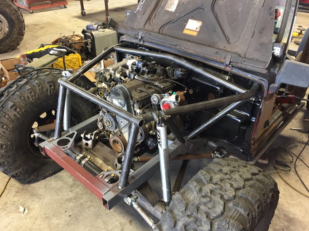

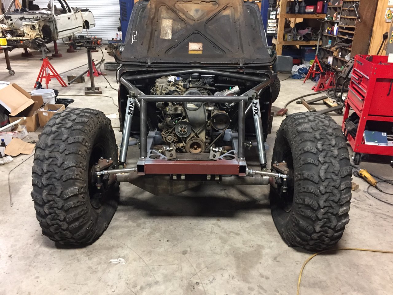

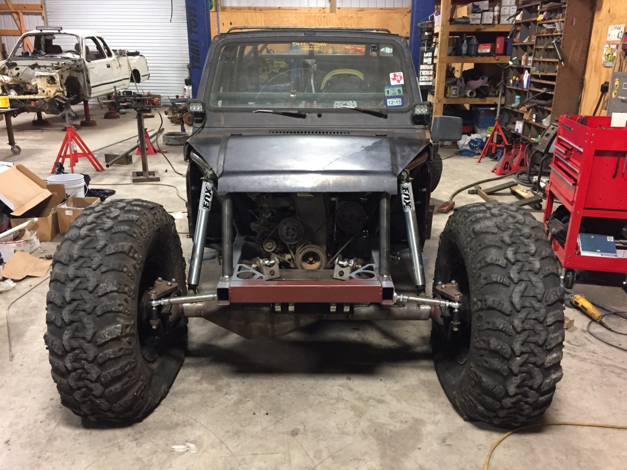

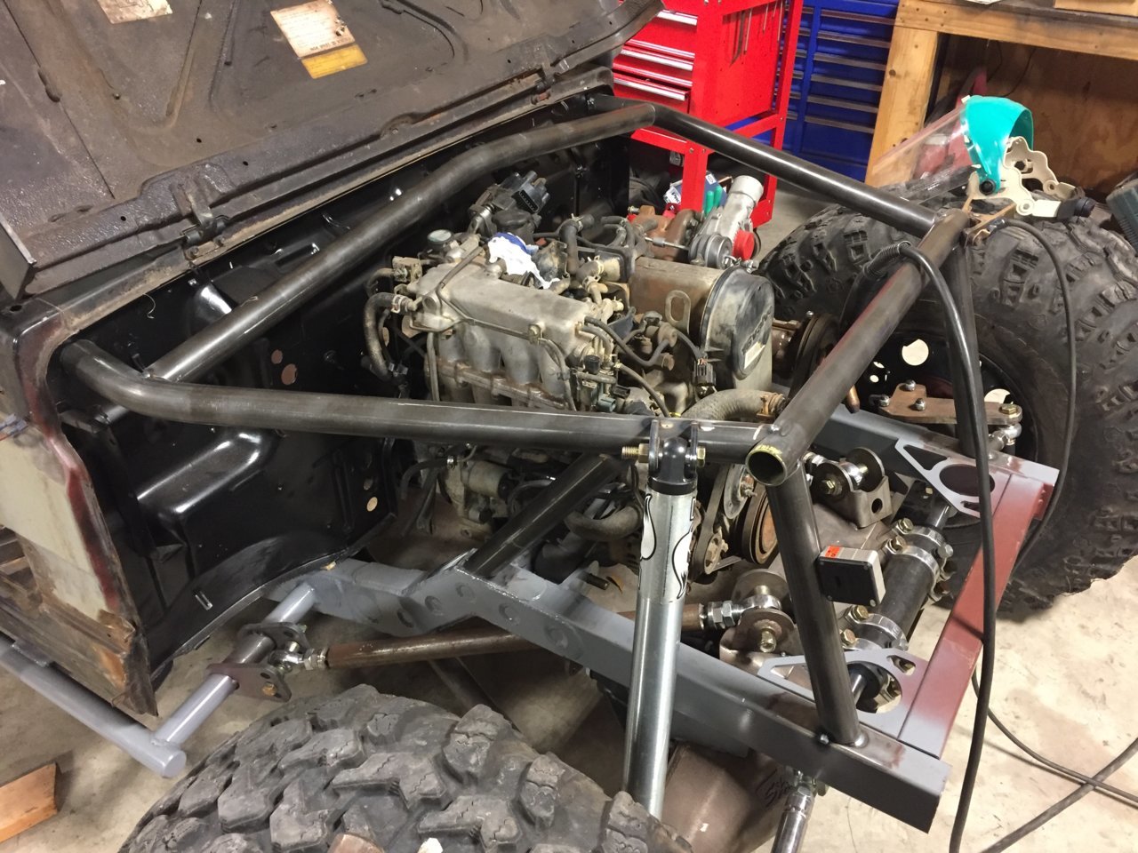

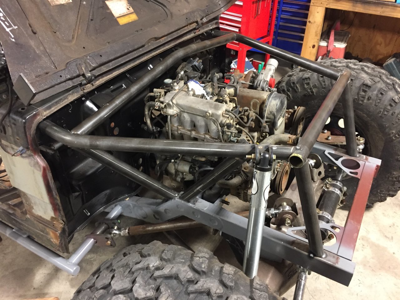

    Time to fire up the bender and see what this front clip is going to look like.
    Photo Feb 28, 1 57 23 PM.jpg Photo Feb 28, 1 57 35 PM.jpg Photo Feb 28, 1 57 45 PM.jpg Photo Feb 28, 2 01 11 PM.jpg Photo Feb 28, 2 02 17 PM.jpg

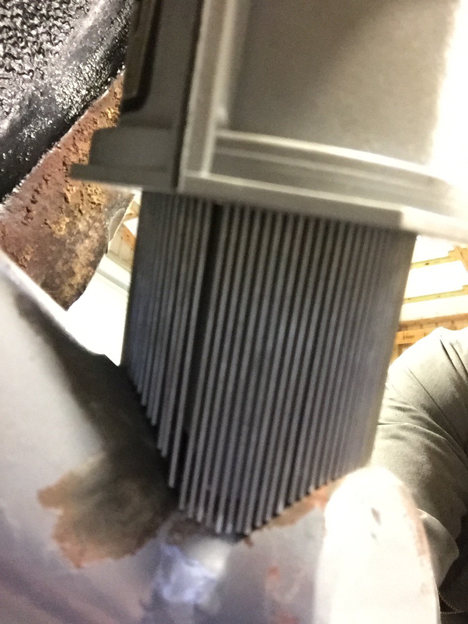

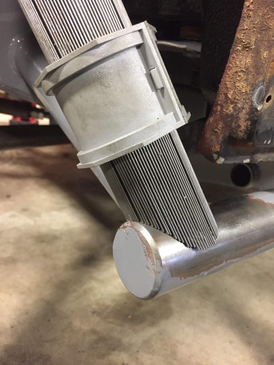

    Plenty of room for the radiator. There will be a bit more of a bumper added so the winch will sit in front of the radiator.

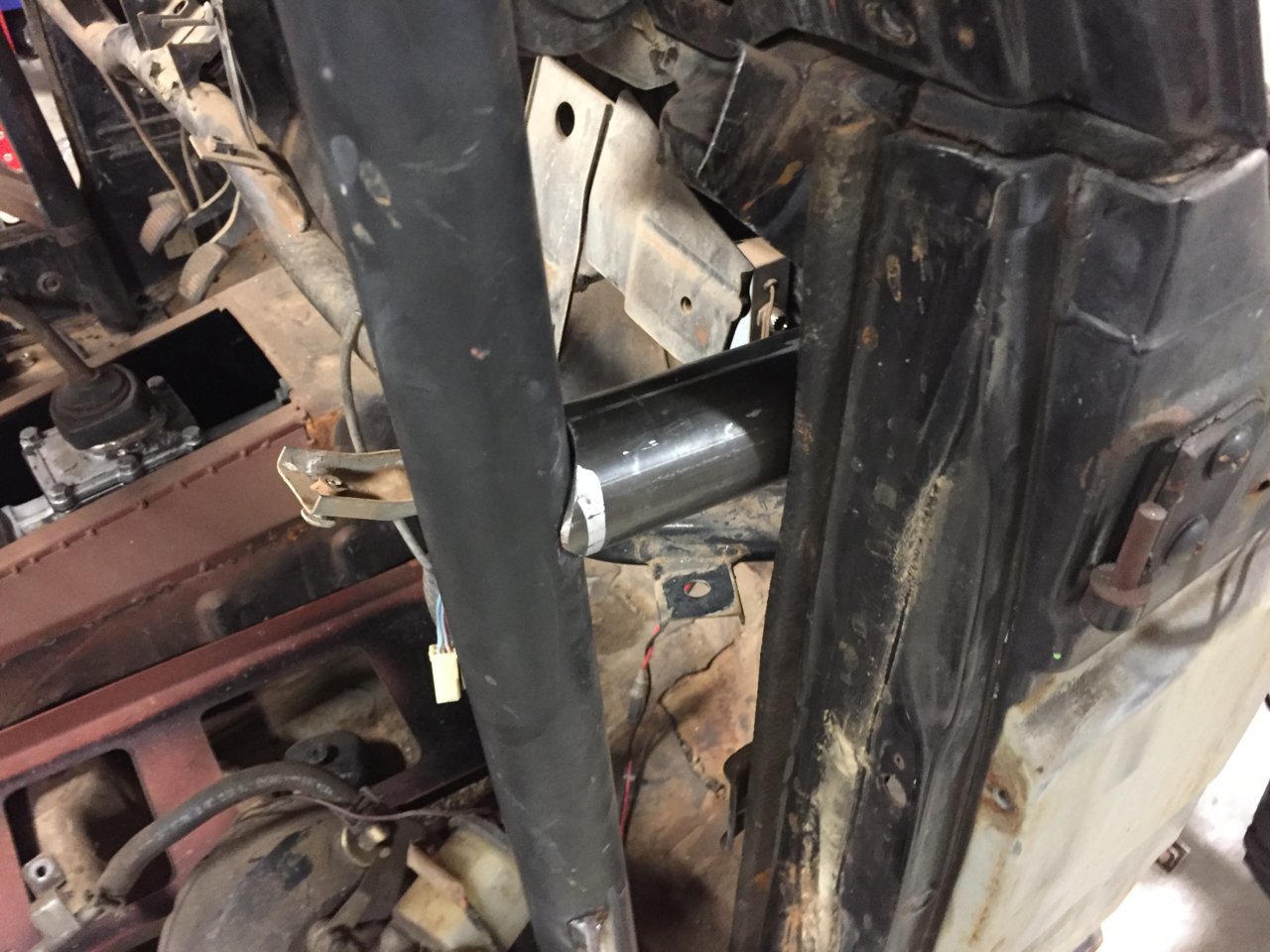

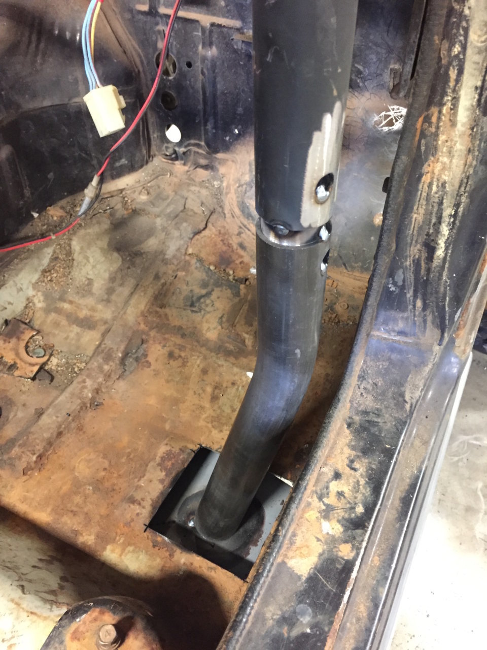

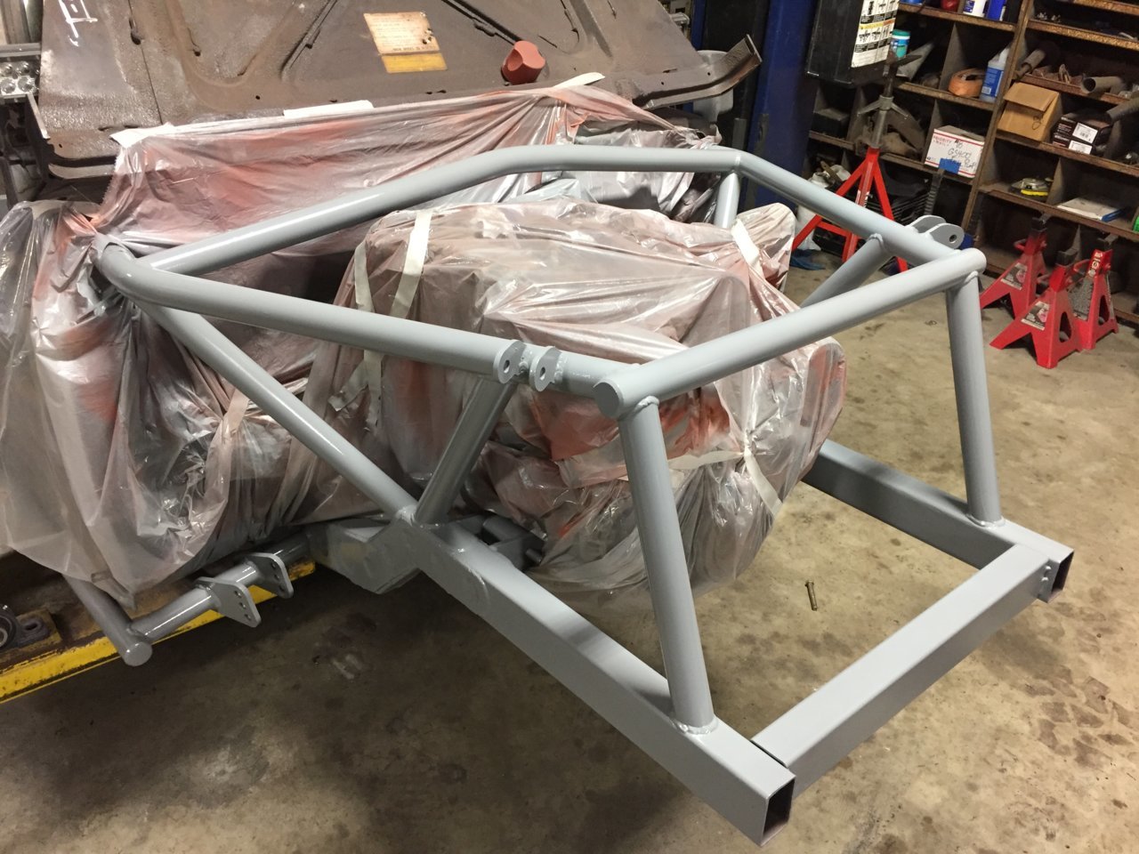

    The original cage in the sami leaves a bit to be desired, so I'm going to beef it up a little. I'm starting with tying the A and B pillars directly to the chassis.

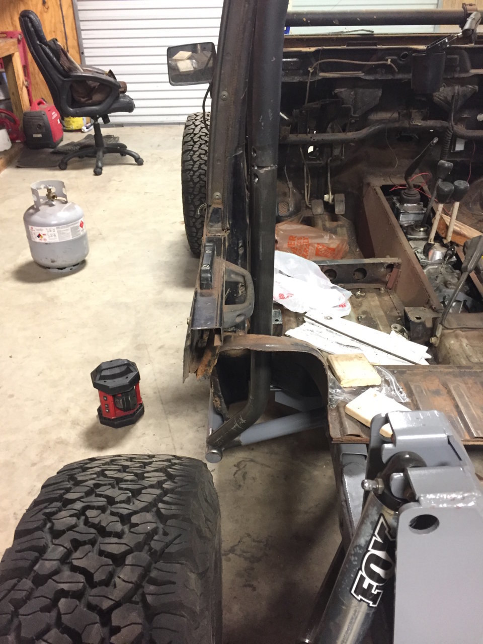

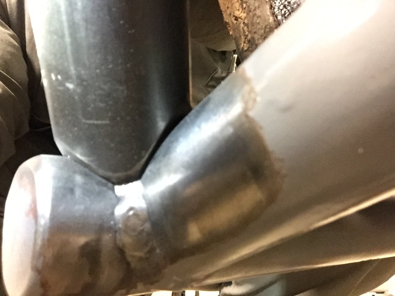

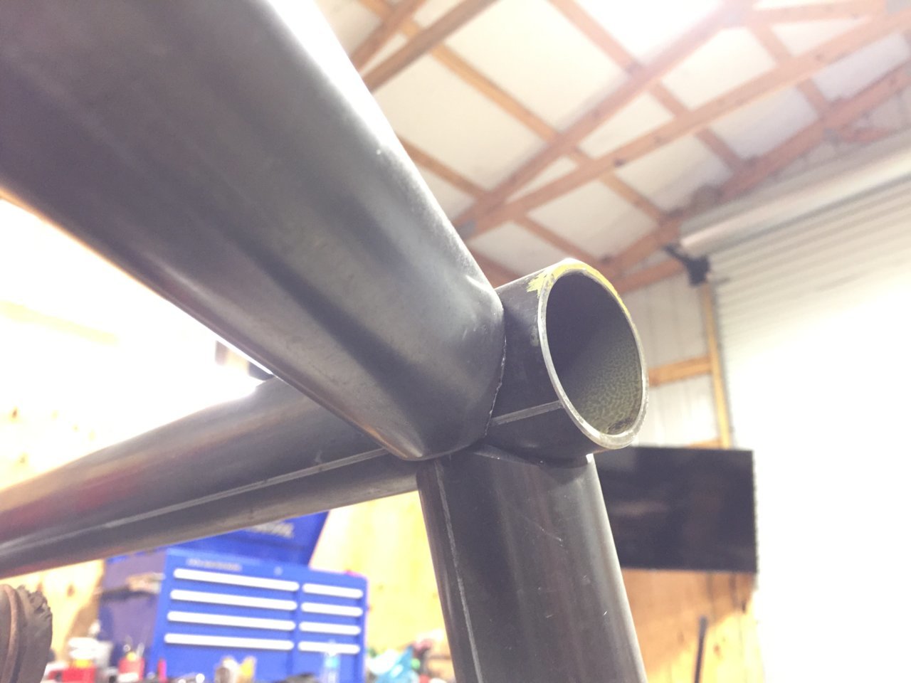

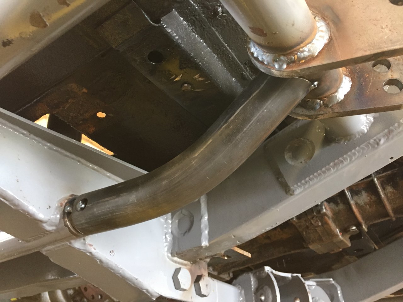

    The cage needs a lot of love, but for now I'll settle for tying the A and B pillar into the chassis. I cut the back end of the cage off as it's going to be reworked once the bench seat goes in.

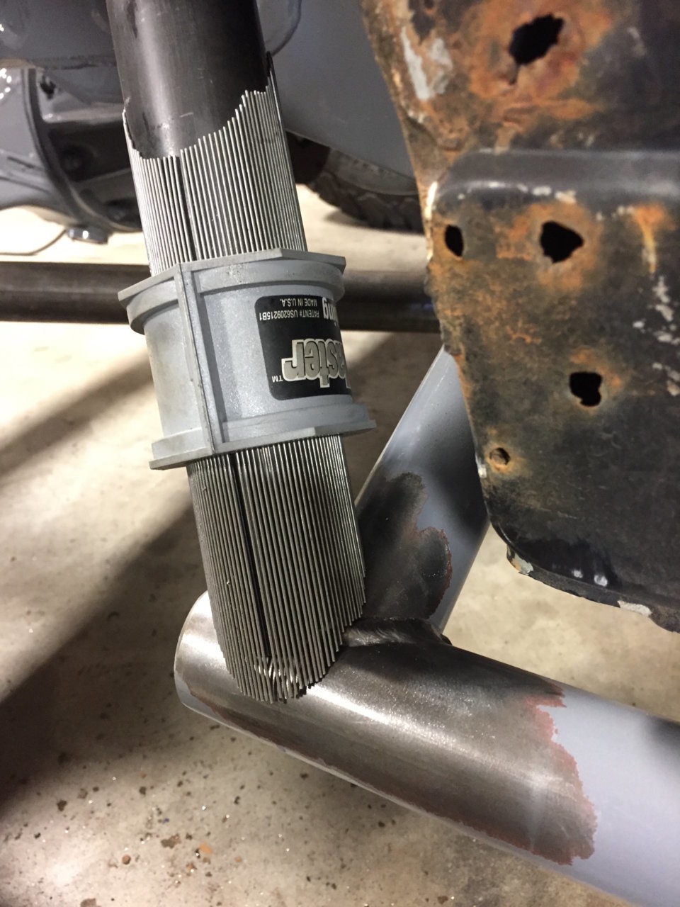

    I finally broke down and bought a pipemaster to help out with complicated copes. It works pretty nicely.
    Photo Mar 06, 1 52 42 PM.jpg Photo Mar 06, 1 52 49 PM.jpg Photo Mar 06, 1 52 58 PM.jpg Photo Mar 06, 12 21 50 PM.jpg Photo Mar 06, 12 22 11 PM.jpg Photo Mar 06, 12 23 00 PM.jpg
    No more need to worry about redoing the front body mounts. This should do the trick. biggrin_127035e842e5dd48052fb9139f75c20526cfff9a.gif

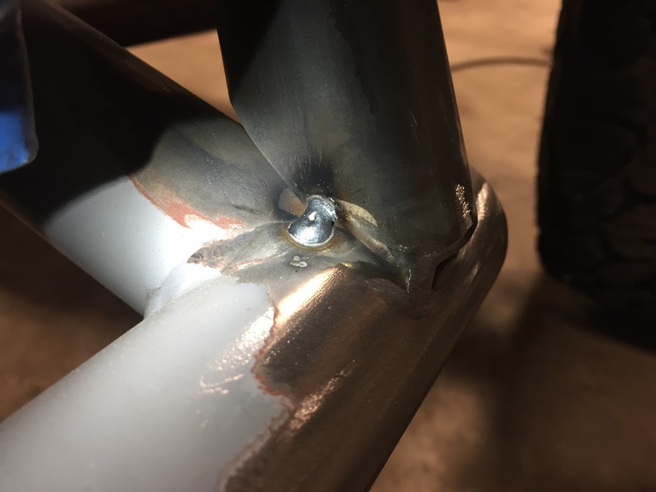

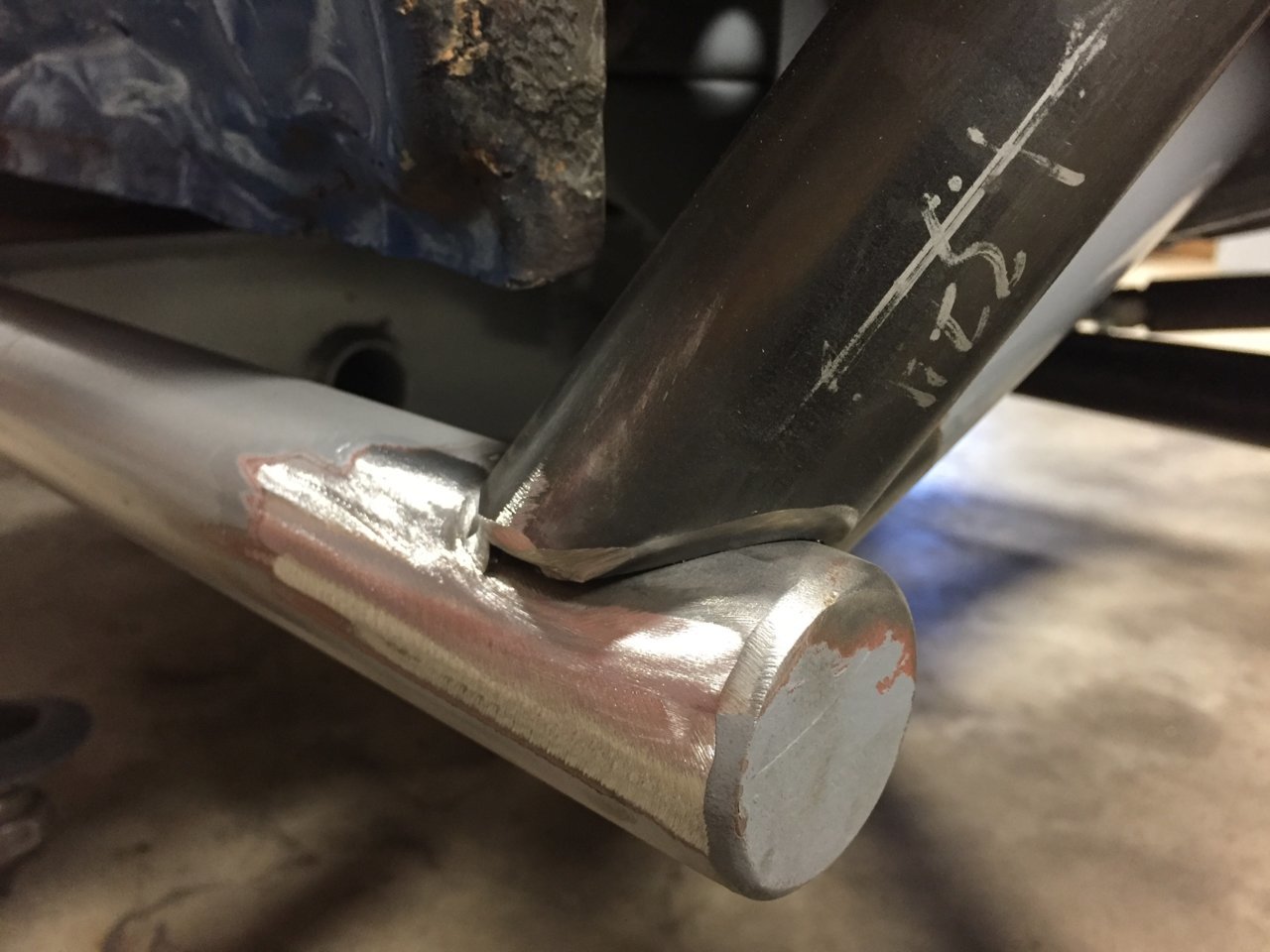

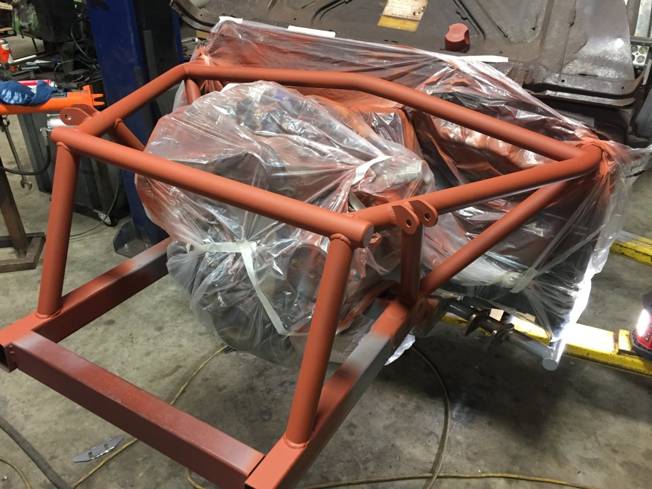

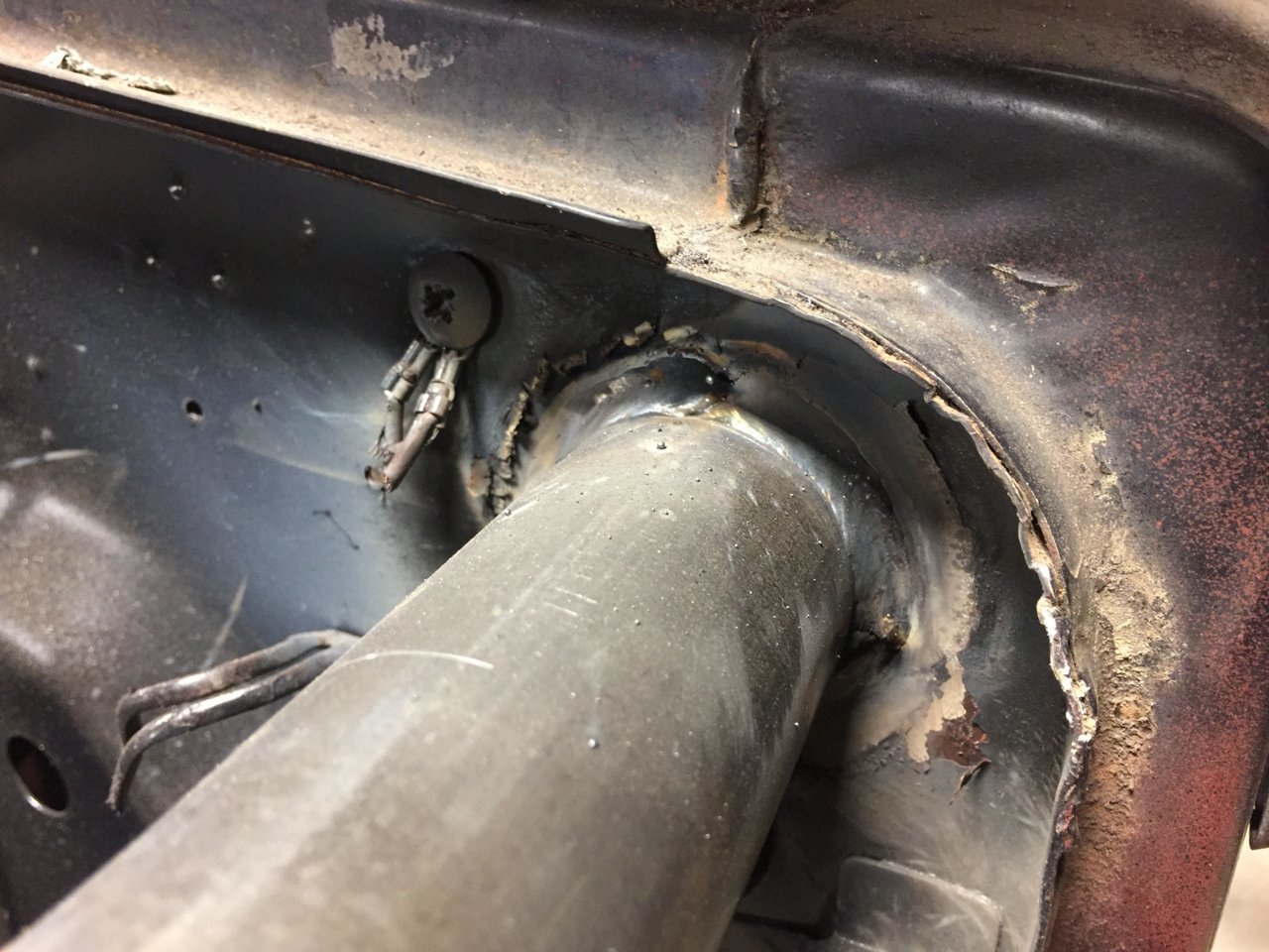

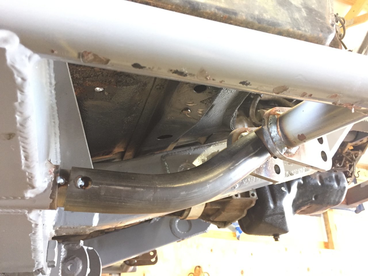

    I reinforced the upper link mounts up front. More than likely the tube and mount would have been fine, but no need to take a chance.
    And I put some paint on her. She's almost ready to head back to Patrick for the finishing touches.
    Photo Mar 08, 6 42 14 PM.jpg Photo Mar 08, 7 42 53 PM.jpg Photo Mar 08, 8 18 05 PM.jpg
