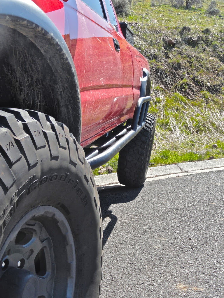

  15. Mar 22, 2013 at 7:25 PM
    #295
    PcBuilder14
    PcBuilder14 [OP] Well-Known Member
    Jun 19, 2011
    #58522
    23,312
    Brent
    Nor Cal
    2018 Tacoma TRD Off Road 4x4
  16. Mar 22, 2013 at 7:34 PM

  18. Mar 22, 2013 at 9:41 PM
    #298
    banditstpk
    banditstpk Pabst knows best
    Jan 14, 2013
    #95203
    606
    patrick
    buckeye arizona
    00 3.4L PreRunner TRD SR5 Xtracab
    deck plate, led lights interior, center hubs painted black,
    do those wheels you have rub the brake caliper at all?
  19. Mar 22, 2013 at 9:43 PM
    #299
    PcBuilder14
    Jun 19, 2011
    #58522
    23,312
    Brent
    Nor Cal
    Yes... I had to put 1/4" wheel spacers up front to fit them. It took about 2 full turns of thread away from the lug nuts, but I've been checking them and so far they haven't backed off the thread. I'll keep checking them every few days and post on here if they start to back off. If they do I'll just put on extended wheel studs.
