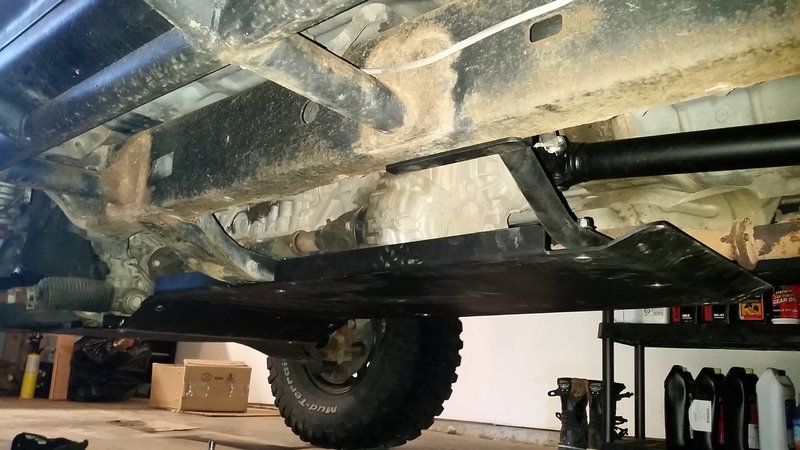

    Nor Cal
    2018 Tacoma TRD Off Road 4x4
    Got my Bud Built belly skids installed. Had one bolt give me trouble making it take forever to get lined up as you can tell by the boot print on the side of the skid... Haha
    And yes, I'm currently in the process of cleaning off the rust/dirt and coating the frame.

  12. Jan 3, 2016 at 12:41 PM
    #4892
    gray223
    gray223 Well-Known Member
    Nov 6, 2013
    #116062
    3,439
    SE Missouri
    2014 Tundra Limited
    Interesting. I've been wondering what it would take to make one.... How does the mount the touches the frame attached to the frame?
  13. Jan 3, 2016 at 1:00 PM
    #4893
    PcBuilder14
    PcBuilder14 [OP] Well-Known Member
    Jun 19, 2011
    #58522
    23,312
    Brent
    Nor Cal
    It bolts to 4 holes (including the 3 that hold the emergency brake adjuster on) on the driver side, and it uses weld nuts into 3 holes already in the passenger side of the frame.
    gray223[QUOTED] likes this.

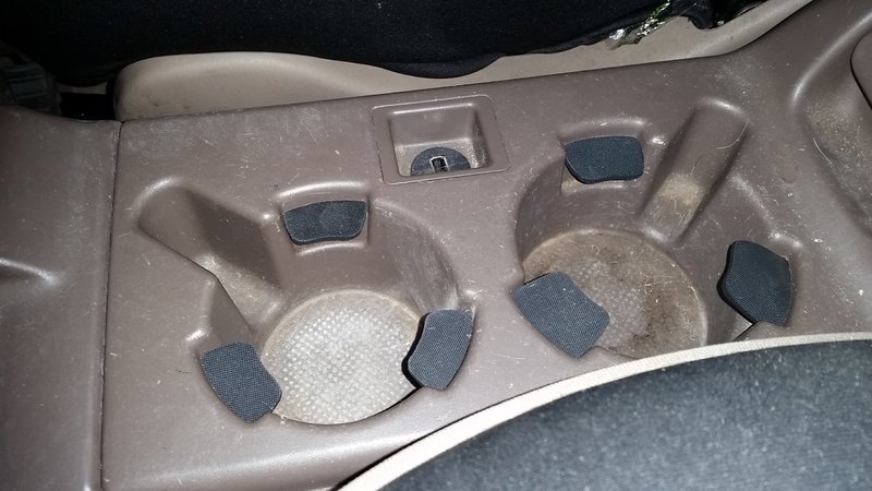

  14. Jan 3, 2016 at 4:21 PM
    #4894
    PcBuilder14
    Jun 19, 2011
    #58522
    23,312
    Brent
    Nor Cal
    Finally got around to replacing the rubber cup holder things as well.
  15. Jan 3, 2016 at 5:20 PM
    #4895
    cynicalrider
    cynicalrider #NFG
    Jul 25, 2012
    #83399
    17,160
    Jersey
    01 SR5 TRD 4x4, '23 Bronco Wildtrak, 2017 HSQV FE350
    Drop bracket lift and booger welds
    Mousepad or oem replacement?
  16. Jan 3, 2016 at 5:28 PM
    #4896
    PcBuilder14
    Jun 19, 2011
    #58522
    23,312
    Brent
    Nor Cal
    OEM. Same exact material as a mouse pad though haha
