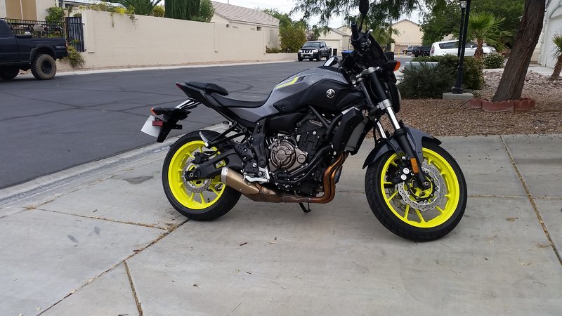

    Gave the bike it's first wash. The wheels were a pain to clean just like everybody said haha but when they're finally clean :drool:
    Then both the bikes had to sit outside for a bit while I finally started organizing the garage.
