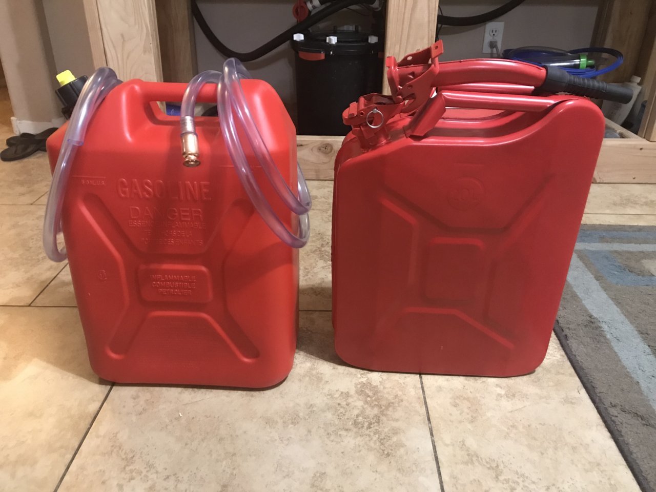

    Bought a couple different jerry cans after my cheap Walmart one split open on me on the last trip.
    I think I’ll be sticking with the plastic one over the metal one. Time will tell though. The metal one already has paint chips.
    Also grabbed a couple shaker siphons after getting to use @Norilsk siphon during the Mojave Road trip. Seriously, if you hate filling up things with a gas can then you need to get one. Super easy to use and siphons fuel really quickly.

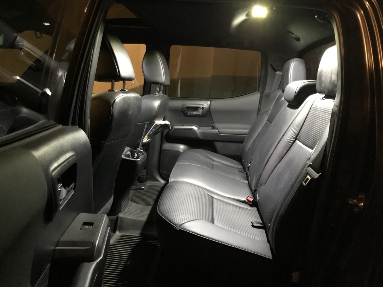

    My Meso Customs dome light came in today. Now the dome light matches the map lights and it is so much brighter. I can actually see inside my truck at night now!

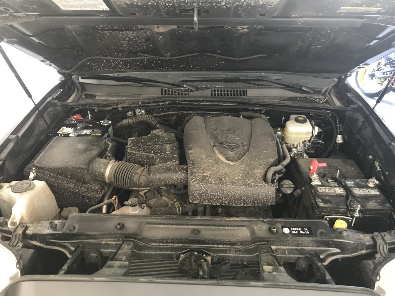

    Off Grid Engineering dual battery kit installed. It’s a really nice kit. Only thing I had to do that I wasn’t expecting was modify the OEM battery tie down. The Off Grid Engineering one was too wide for the OEM battery but the OEM tie down bolts weren’t long enough for the primary batter platform. Some dremel work and it’s together now.

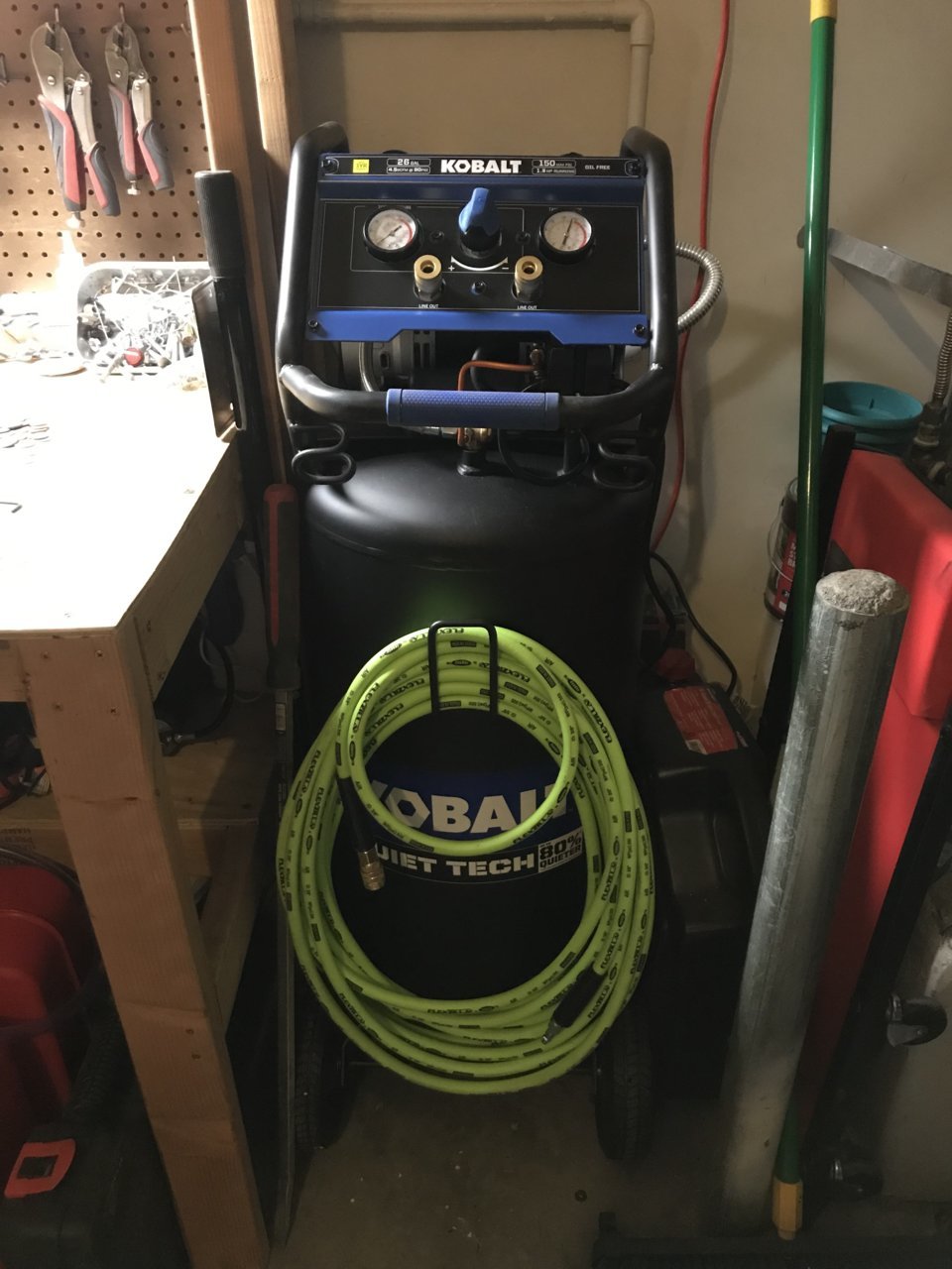

    An upcoming truck mod gave me a good excuse to finally get an air compressor. Hopefully this will make my life much easier in the future!
  15. Dec 26, 2018 at 9:02 AM
    #95
    max_o
    max_o Well-Known Member
    Sep 2, 2018
    #264906
    160
    Colorado
    2018 Silver Sky DCSB OR
    An air compressor is a life changer if you do your own work. I couldn't live without mine now. And love the dual battery setup.

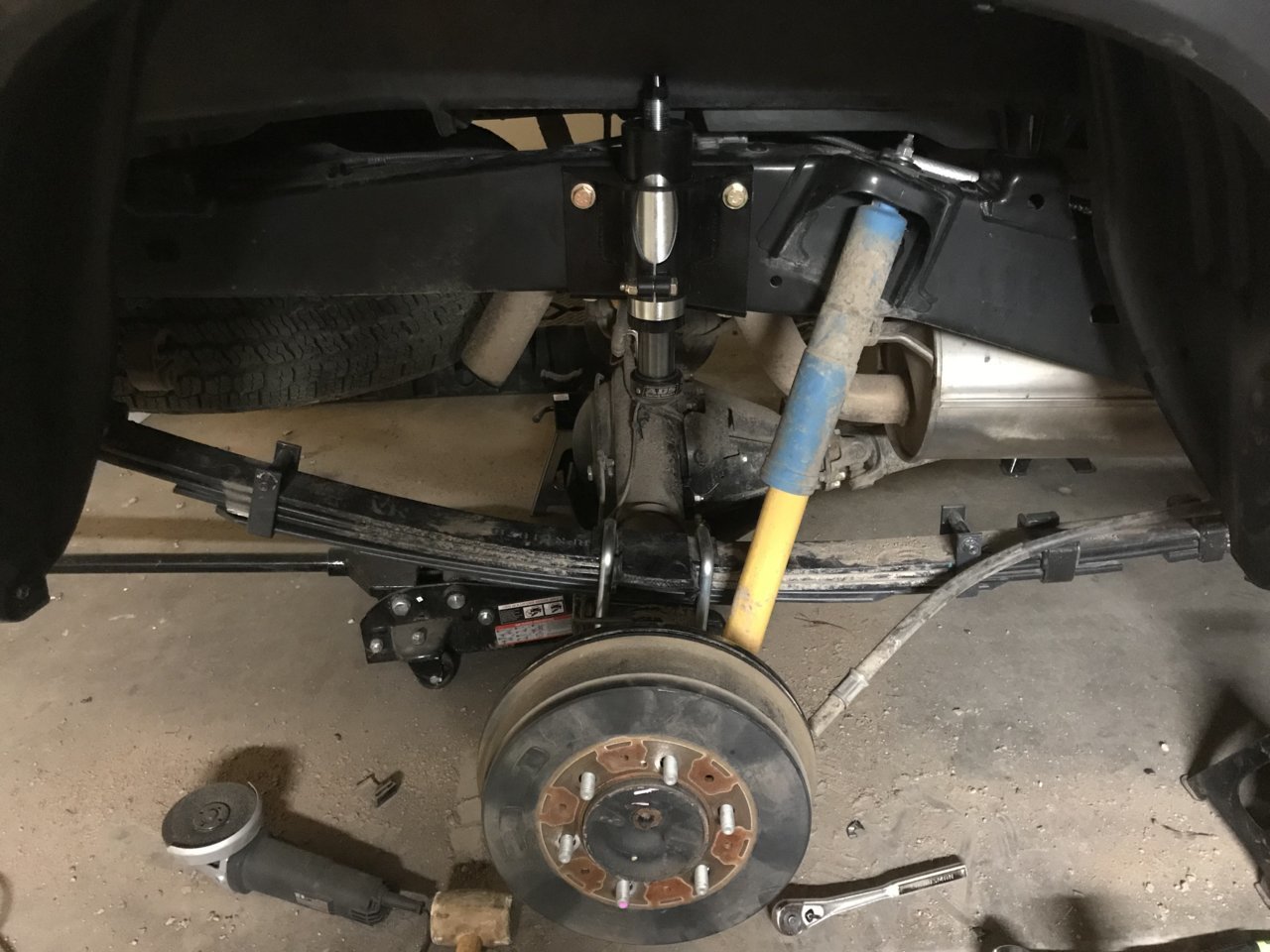

    Got the Wheeler’s 3-leaf AAL kit and the passenger side of the ADS bump stop kit installed. Air hammer is a life saver against those rivets.
    I’ll finish the driver side tomorrow, my back hurts too much :oops:

    You got rid of the overload as far as I can see?

    Yeah, that's how Wheeler's recommends installing them but I might reinstall them later depending on how the AAL's handle the weight.

    With the weight you were running you might want to put it back once it settles a bit :bikewhoops:
    Also, watch for the shocks to not to over extend on trails, you now got some serious flexing. :thumbsup:
