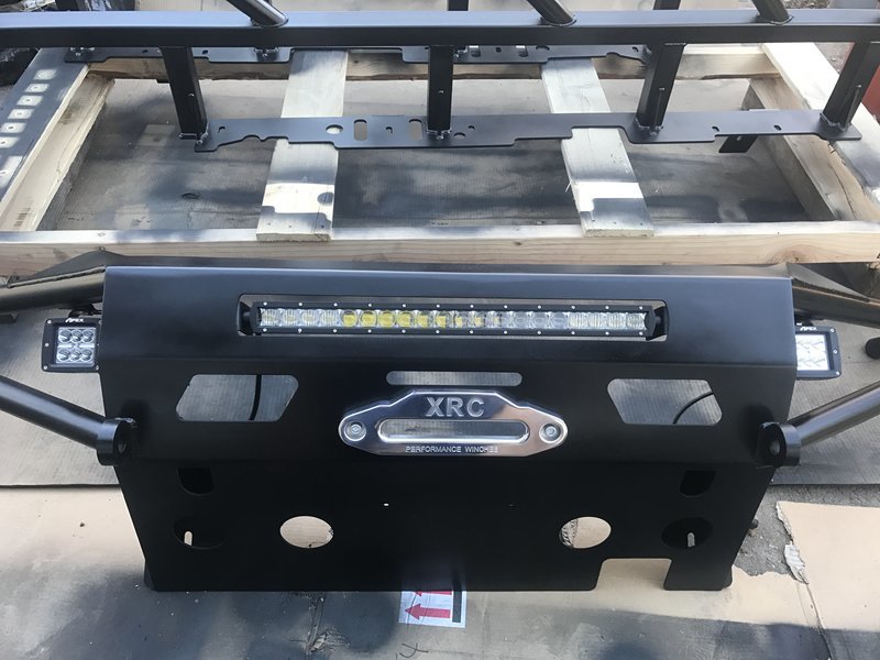

    It wont fit without modification. I have the 12-15 hybrid. Luckily I ordered it raw and was able to cut, move and re-weld the mounts about 1/4" outboard of their original locations. The dimensions on CaliRaised site are a bit off.
    This photo is from @inv3ctiv3 's build using the same lightbar and you can see how much he had to bend the tabs (upper right hand photo of picture) to get it to fit.
