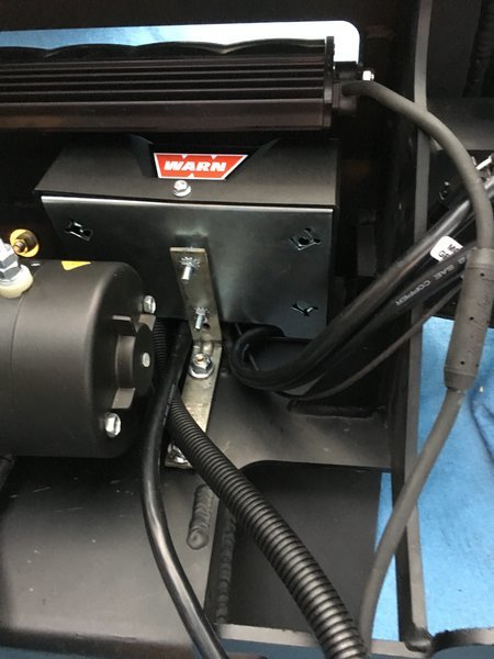

    This is how I mounted my Warn VR10000s

    All you did was drill a few holes for the bracket? That setup looks real clean and easy to attach the controller.

    Exactly had to drill one more hole in the bracket and two holes in the bumper. I put a strip of 3M tape & mtb tube between the bumper & solenoid to dampen any vibration.
    Very easy access to attach the controller
