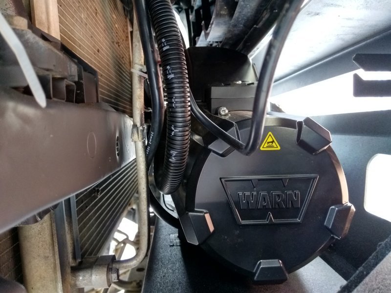

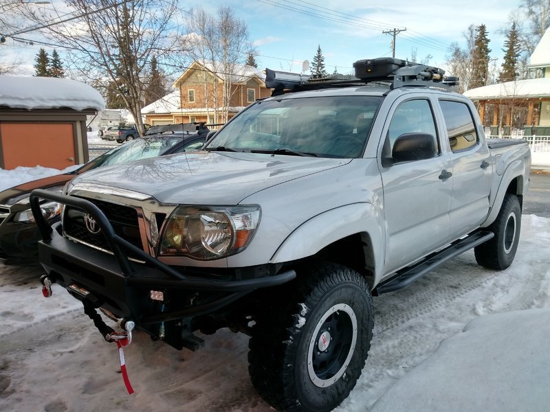

    Some notes from my hybrid front install on my 2011 -
    A Zeon 8 fits without relocating the control pack, but requires trimming the center radiator support, lower grill mount and leaving off the cross bar that he bottom of the grill sits on. If you don't trim anything up from the bottom of the grill the bumper must be set at the lowest position as opposed to being raised tight against the fender lines. If you don't have skinny arms you won't be able to reach the control pack to plug in the controller either.
    There is plenty of clearance between the winch and the hard AC lines behind the bumper. My winch is set all the way forward in the tray to ensure clearance. I could probably slide it back a bit more and that might allow less grill trimming to move the bumper higher.
    The Zeon 8 and Zeon 10 should fit the same way, according to Warn's website they are the same overall dimensions.
    Put the license plate on the bumper before you install the bumper. I didn't and it was a pain to reach back up inside to bolt it on.
