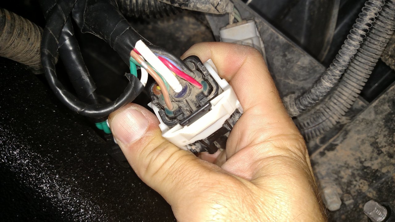

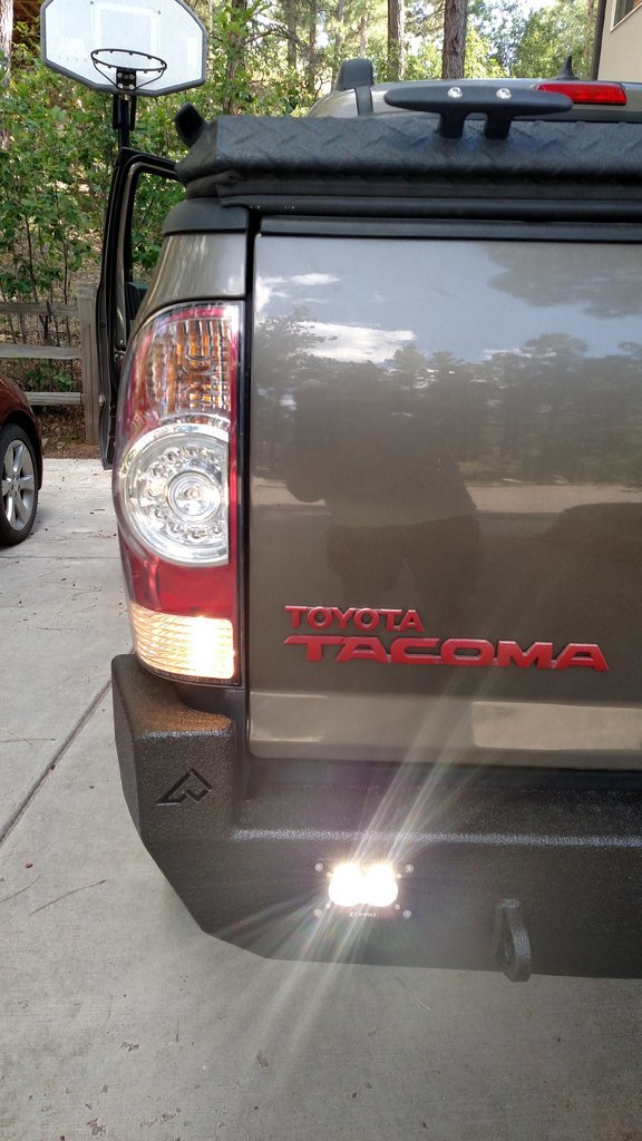

    Here you go. These are after the fact, but show the result.
    The Baja Design's S2 Pro wide-cornering flush mount lights come with installed metripack connectors and the needed parts to assemble the mating fittings on your supply wire. You will need a crimper.
    First find the harness connector under the truck to the left of the trailer hitch. It comes apart by squeezing the small black tabs on either side of the black protrusion on the female side which will release the white locking cover. Figuring out how to disconnect this fitting probably took me longer than any other part of this install!
    The reverse light power is carried through the yellow wire with silver trace on my 2015. The larger white wire is the ground. If you need to verify, the connectors are all labeled inside the other end of the harness so it is easy to ring them out.
    IMG_20170809_173500404.jpg I opened the wire comb and several inches back from the end I carefully stripped about .5 inch of each wire to allow me to make strong solder connections to my lead wires for the new lights. Once connected, just tape it all up real well, put it back inside the comb, and then tape that closed and seal the end.
    IMG_20170809_173639874.jpg I chose to make the parallel connection between the two lights inside the metripack connection to the closest lamp by soldering the wire ends together before making the crimp connection. To do this, I used a larger wire seal than the ones supplied, but I found the connectors big enough to make a solid crimp over the soldered connection.
    I stuffed the wire between the two light connectors into wire comb and taped it closed for good protection.
    Connect all the fittings and tuck it up out of the way and secure as necessary with zip ties.
    I highly recommend these lights. They are solidly built and they are bright, and the Pelfreybilt cutouts are a precision fit. With this installation, they come on in reverse, and are protected by the 10 Amp trailer reverse light fuse under the dash.IMG_20170809_173813481.jpg

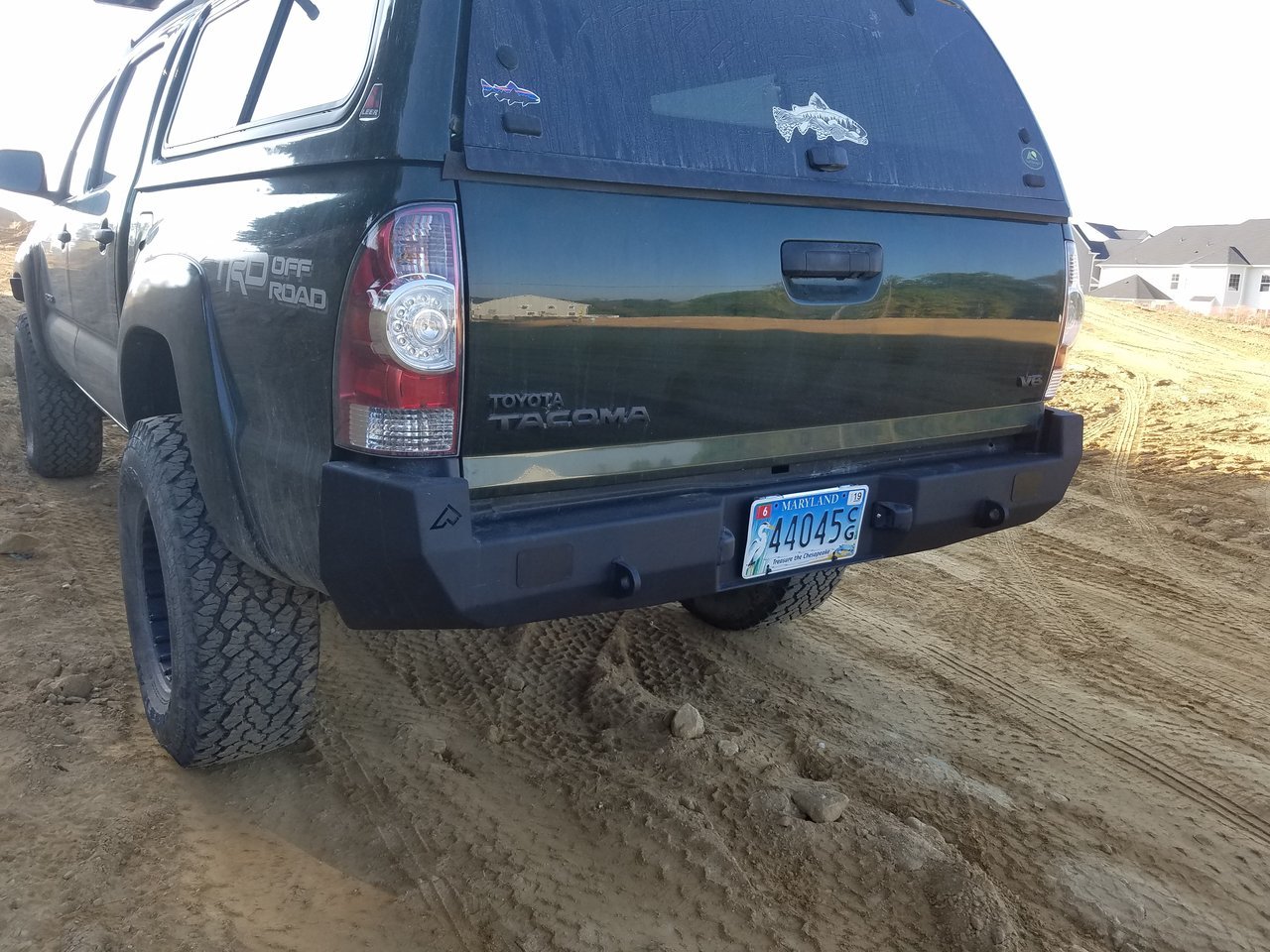

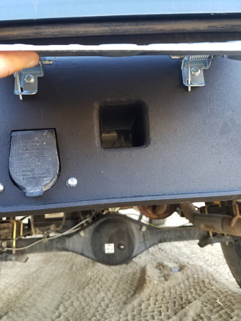

    Got my bumper installed last night. I think I can adjust it a bit more to get it closer to the tail lights and tailgate, or at least im going to try.
    For the flip plate, I oriented it so it would flip up and it has tension when lifting. Here's how it looks
    Is there a way to lock it in the upright position? Or do I just lift, slide in my receiver, then let the tension push it back down? Kinda funny that the hardest part of this whole install was the damn license plate haha

    Sick looking bumper man. It looks good on your truck. Does that license plate flip up holder come with the bumper or did you order it separate?

    Thanks man! It came with the bumper, haven't had a chance to tow with it since installing it. My only concern is that the plate might come really close to the ball of the hitch, in which case I might figure out another mounting option
