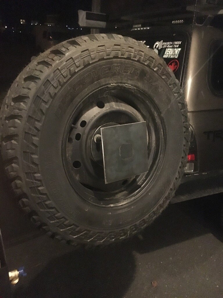

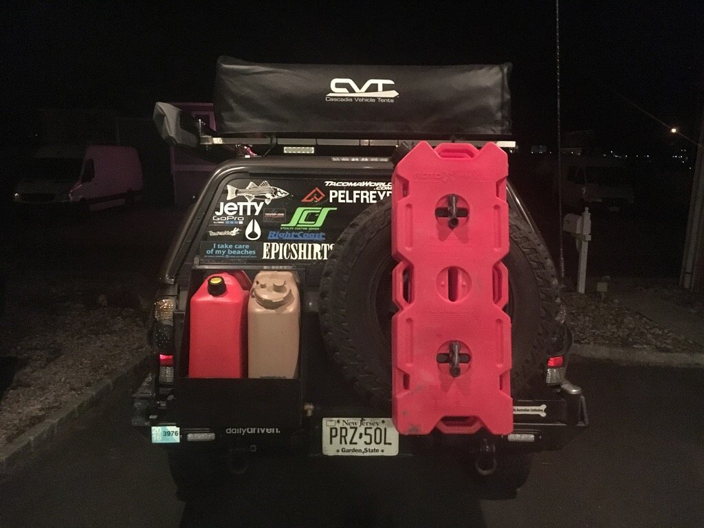

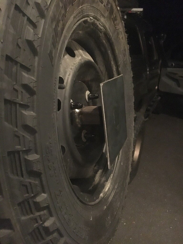

    Thanx. I made a mount to be secured with the 3 lugs holding the spare tire, than the rotopax 4gal mount is bolted to my mount.

    Awesome! I don't have the metal fab skills, so I'll have to be on the lookout for something that'll work then. Thanks for the pics!

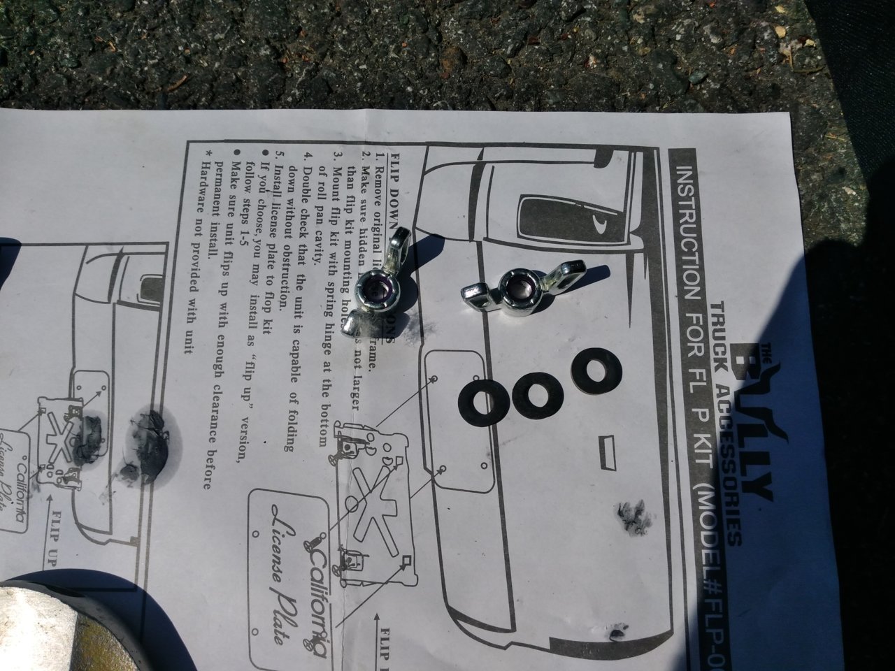

    Are these supposed to go anywhere for a second gen standard rear bumper with swingout, no table or hilift mount? Would be nice if a $1600 bumper came with a parts and tools list and actual instructions. Pretty sure I figured it out and got it installed but those would've made the job a lot simpler.

    I believe those are for the table, you might have just gotten them by accident. Oh, and I need a new flip kit after backing into something.. what is the rest of the part number after FLP-0..? :D

    Those are for the table, they are standard in the hardware kit! The table can be added later with a riveter if you keep those you will have everything you need!

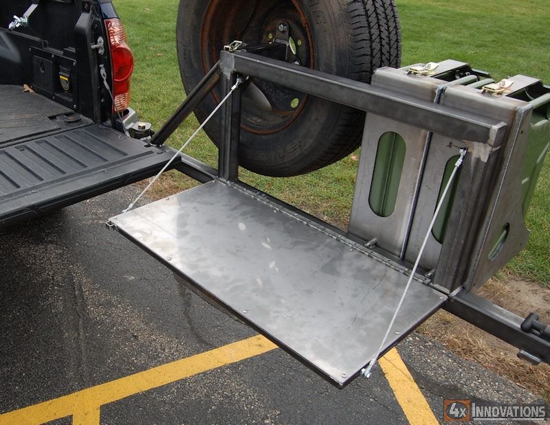

    Can you provide a picture as to how the table is secured and how those wing nuts and rubber washers are used? Or just an explanation ha.

    The wing nuts are to hold the table in the up position. Generally this is how the tables are made and those wing nuts go at the top to hold it closed except the one below has a latch to keep it closed

    Yea after a little more searching I found an image showing that. I think they forgot to attach the stud for the wing nuts to tighten down. There are two center punch marks where they should be.
