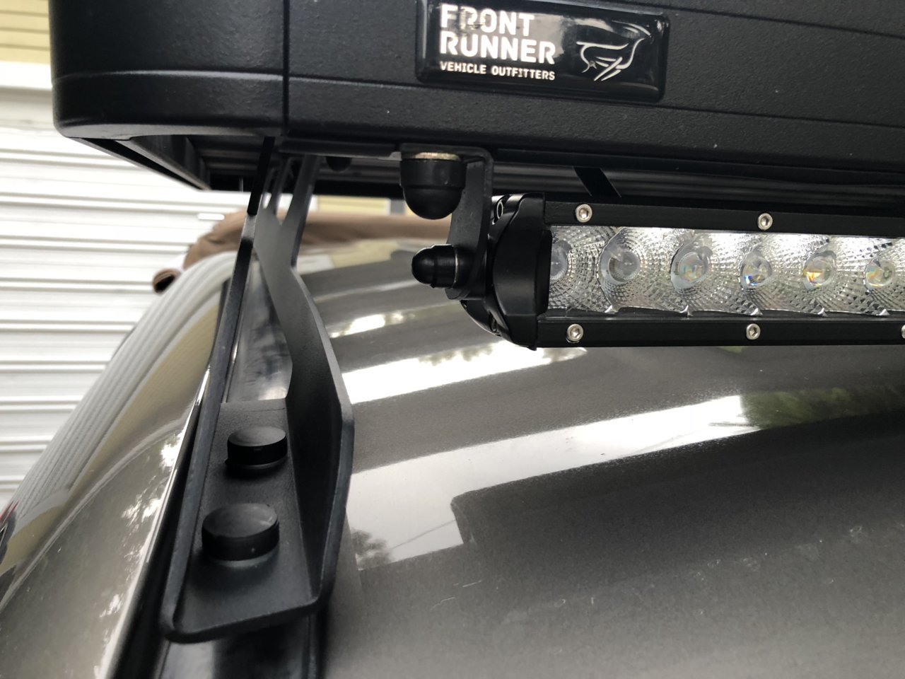

    How far from the windshield did you mount the rack?
    What length rivnuts did you use? What bolt size?

    I had a lot of wind noise till I installed FR gasket material they sell in the channels. It fixed 90% of the noise. I might have a little wind noise from LED light bar. But very minimal...

    I’ll head out and measure up this numbers for you, I’ll send a PM. I’m not sure the size on the rivnuts maybe @GHOST SHIP can chime in on some numbers!

    They were M8, I believe. Standard depth. The knurling on the rivnut is just long enough for the mushroom to spread inside the roof panel and lock it in place. I always have to remind people that rivnuts are not high-torque fasteners so you don't have to be a gorilla to install them and they'll work just fine.

    Thanks, it looked like you used some kind of caps on the bolts, if so what are they and where did you get them?

    The bolts that came with my Pelfrey rails are either M6 or 1/4”, did you guys go bigger?

    I bought them at orchard hardware supply, but I’m sure you can find them on Amazon! They were just the right size for the head of the bolt. Worked great.

    They may have been M6. I honestly don’t remember. When we did the install, @4T3Underhill had the bolts and I just matched them to the corresponding rivnuts I had on hand. I remember them being metric but they were either M6 or M8.
    Those bolt caps are really cool. (They’re called bolt caps BTW). I think I found some at Lowes too after we did the install. I’ll see if I can find a link.

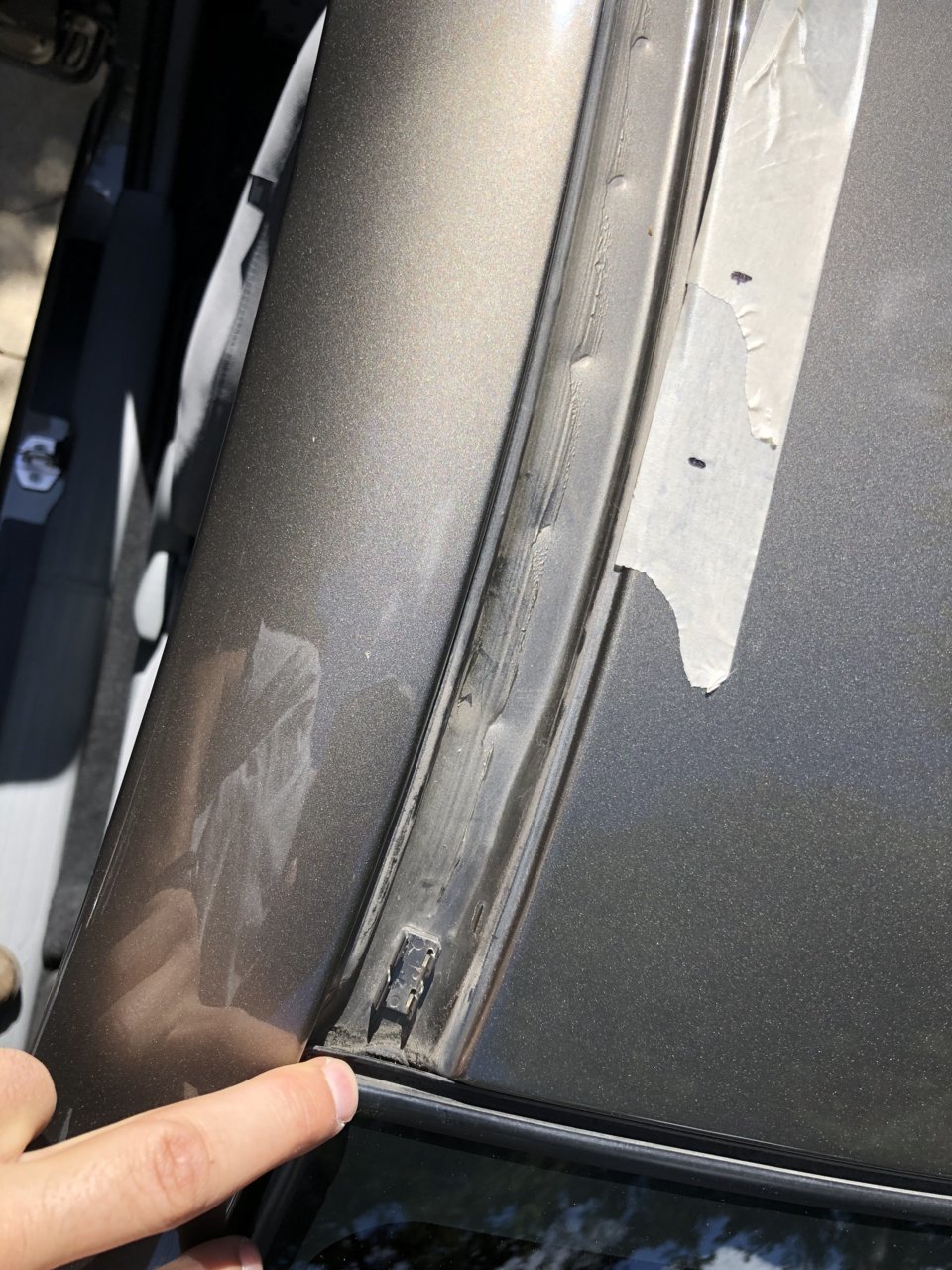

    Those helped on our install also. Just limits the chance of going right to the headliner or any other part. Also something that I forgot to do that I wish I had was, when you drill the holes into the sheet-metal take some color matched touch up paint and paint the bare metal edge in the hole where you drilled. Just an extra small step to help avoid possible rust or corrosion. (I think your on the east coast) i’m originally from Maine.
    Start at 1:00
    https://m.youtube.com/watch?v=HKdJoJHXAZ8
