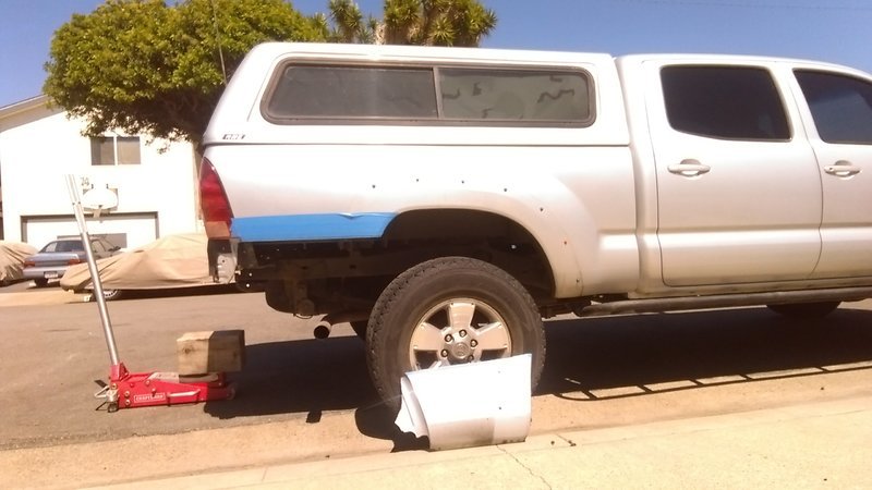

    IMAG1479.jpg Took about 2 hrs of staring at the tape and measuring the line about 20 times to finally get the courage to just cut it.
    The cut went easy though.
