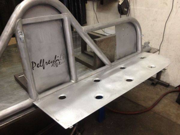

    The table looks good, should provive a little real estate to eat lunch or set your ammo while you pull up the waders.

    Higher cost for round tube swingout? Cost for fold down table?

    The round tube gate cost is same, its just not standard because it tends to oscillate more. Table is $125.00, I think, have to ask the wife, she takes the $$ lol

    tyler is it possible to add one of those tables to an existing bumper?

    It is possible, I have been trying to add one to mine for months.

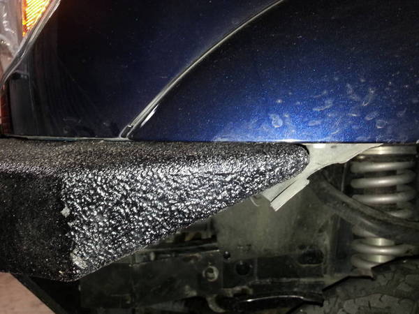

    Just got my bumper from another member here and have one concern. I have a 2012 and the bumper is very close to the fenders on both sides. has anyone had problems where body flex would push the bunper into the fenders? I looked at other pics and they all seem pretty close. It is an awesome bumper. I also had to make a bracket to hold the grill since the factory bumper is no longer there to keep the bottom tight

    Throw a washer in between the frame and bumper on the bottom studs to help shim the bumper away from the fenders.

    How close are you talking about? Mines around 1/2" to 3/4" away and i havent hit it yet. Anything less and it might hit when youre twisting the front.
    I never worried about bottom grill clips either. Kinda forgot about it, but havent had any issues.

    I didn't take a pic, but I glued a strip of 3/16" rubber (scrap rubber from my homemade mudflaps) to the bar directly under the grill. Helps keep it tight and no rattles.

    Im less than a 1/8 inch away. It is not touching, but very close. It is even on both sides. may try to shim the bottom of the bumper to push the sides down a bit

    5/8" gap to allow for flex. That's what I've always gone by.

    ^ yeah, that's really close. you should try to space that a bit with shims. are you already out of adjustment room with the mount points?

    That a bit close. The bumper wont flex much but the frame does and the tips touch the flares some.
    What he said
    Should be able to slide it down a touch and call it good.

    I have the shims, but have not tried it. Gonna try tonight if I can get out of work in time. Need to also get some hardware for the frame attachment point. I will put pics after I shim. Thanks for the advice
    I also installed it by myself. My help did not show up

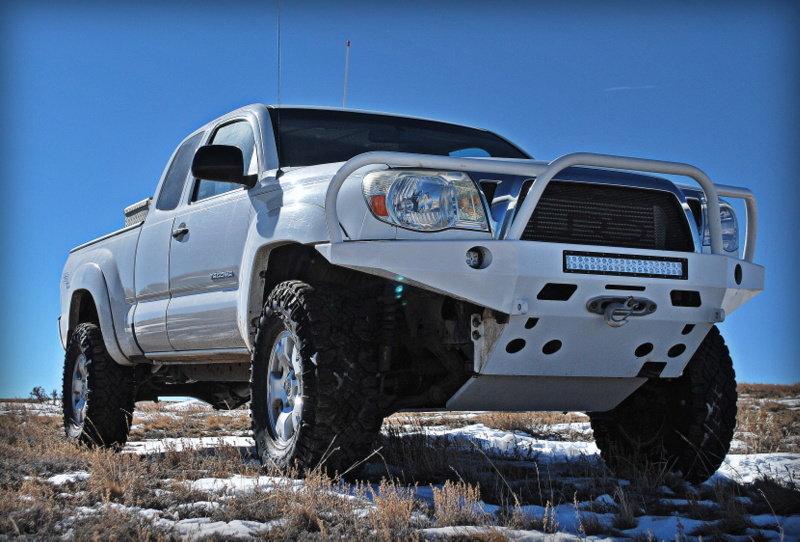

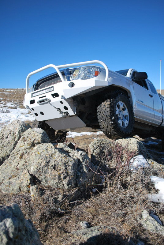

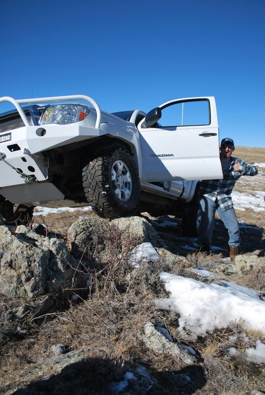

    Here are a couple recent pics you can use on your site. if you want.
