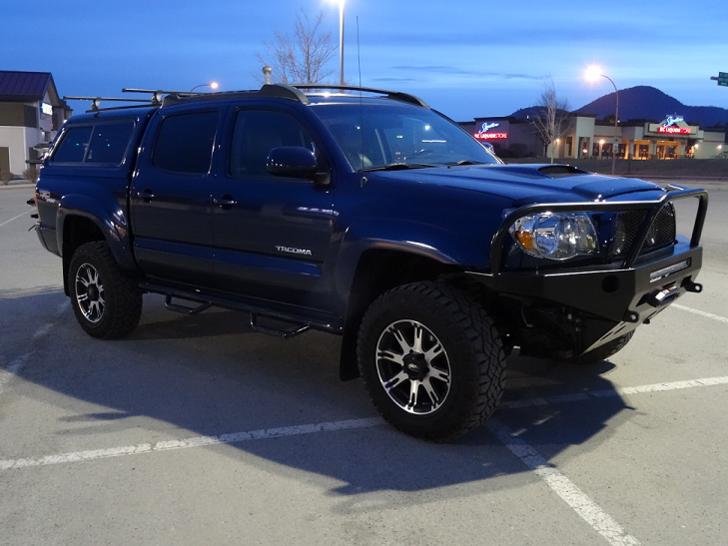

    well, here it is. Its awesome. Just have to correct step one and hook up the lights.

    Ahhh, beautiful, just seeing that makes all the UPS BS seem so worth it. Thank you, I hope you are 100% satisfied with your bumper

    Love it. Yeah it was worth the ups bs. I had it out this morning and another tacoma driver passed going the opposite direction. Too funny, I swear he pulled an exorcist head turn to keep his eyes on my truck/your bumper.

    Sweet bumper sir! Me want :D
