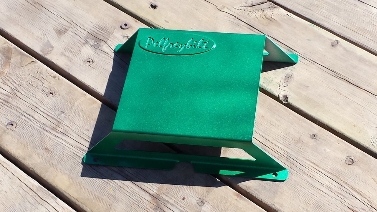

    Another coat or two and then ready for install..

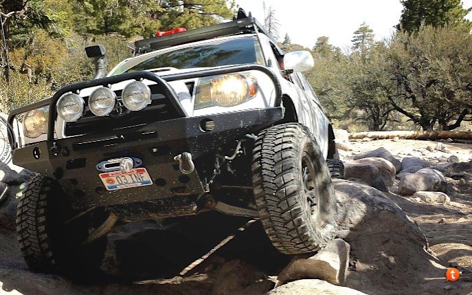

    Anywone have any recomendations on how to mount the licences plate

    If you have a winch, I've seen adapters for roller fairleads to mount the plate there, and I've heard about, but haven't seen, adapters for a hawse.
    That said, mine is currently ziptied just above the fairlead. I really should come up with something myself.

    When people live where they "have to" mount the plate they typically just drill and tap the mounting holes into the bumper, 1/4-20 thread works just fine.

    I used (4) rear earth magnets on the back of my license plate. Pop it on the front below the fairlead when on the road, then take it off when wheeling so I don't lose it or smash it up.

    Drilled holes to mount mine.

    1/4-20 Button head screws

    I used industrial velcro to hold mine on since day 1 and its still there.

    Drilled holes
