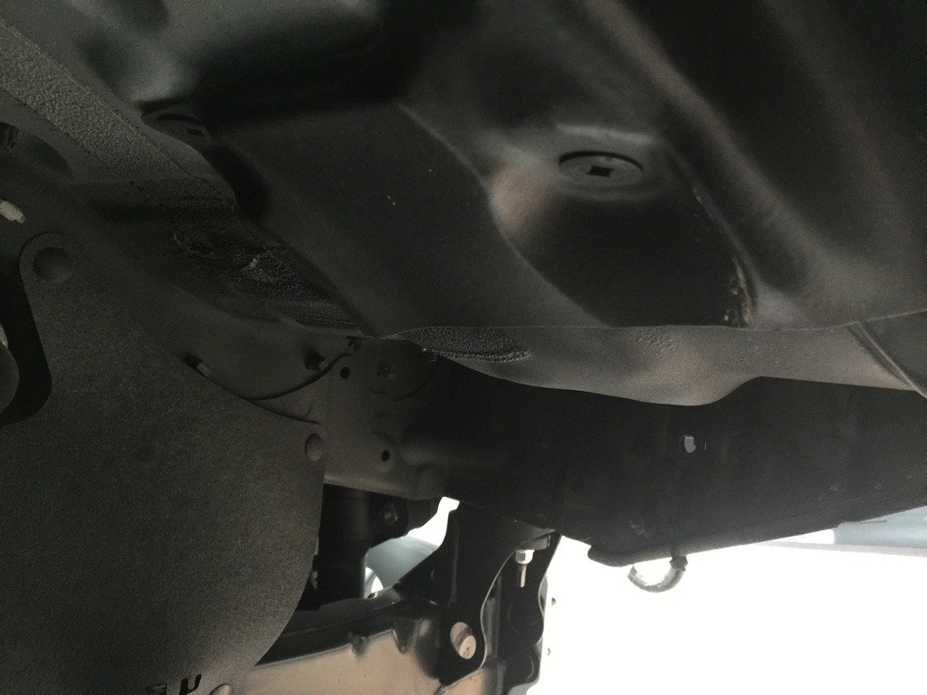

    Taking delivery tomorrow :D. Anyone got a good write up on front bumper removal? I thought I remember seeing somewhere that trimming the inner fender plastic wasn't necessary either.
  7. Aug 12, 2015 at 5:01 PM
    #4127
    TacoSTIG
    TacoSTIG Untamed Member
    Jun 22, 2014
    #132473
    1,140
    Jeremy
    WA, Issaquah
    2005 AC, TRD OR
    I just bent my plastics up out of the way and zip tied them down. It'll make sense when you're up in there.

    No trimming of the inner fender is necessary except for the 05-11, so you're good to go! We sent you written instructions for the installation. The removal of stock bumper is literally as simple as unbolting it & tossing it! ;) HAVE FUN!!! :)

    Trimming isn't "necessary" but I would recommend it. You will see once you remove your bumper that there is a lot of the plastic fender liner that is remaining. I trimmed mine to right in front of the tab holding the liner in place. I used a sharp pair of leather cutting scissors but any sharp pair of scissors will do. The plastic is very thin.

    Also... removing the bumper took less than 10 mins with about 8 screws / clips IIRC.

    I used a razor blade and it cut that plastic like butter... My cut is about the same location, though a little messier

    A fresh razor blade works great on the inner liner.
