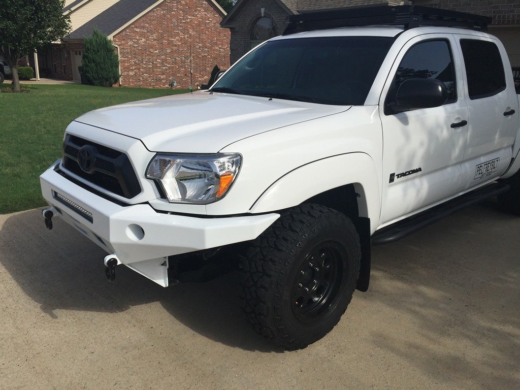

    Pelfreybilt Front Plate Bumper, Brute Force Fab High Clearance Rear Bumper, Pelfreybilt Sliders, OME 886/Dakars, SCS F5's, 33" Ko2's, Cobra 75WXST/3' Firestik, oil catch can, aero turbine 2525, rear differential breather extension, bedmat, weathertech digital fit front/rear, BHLM, custom shiftknob (made by me),
    I'll just add to the itch that I know somebody on here has. If you're on the fence about a bumper, go for it!
