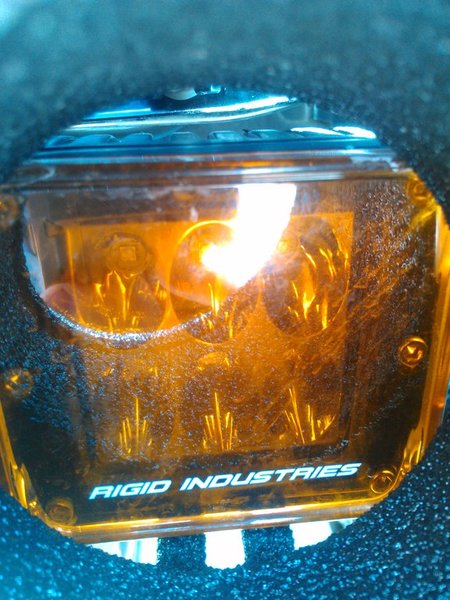

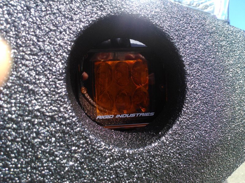

    I took some pics...
    In the second pic you can see (kinda) the clearance between the body of the light and the piece beneath the headlight

    You are definitely going to rub, brother. Out in the desert having fun, i had my bumper clearanced at about 3/8"-1/2" away from my fiberglass fenders...one trip out to the desert and i wore through the paint down to the fiberglas.
    Funny story, i never actually thought about how much the body flexes on the frame until i got my new truck with the 6 speed...if i rest my hand on the stick while driving and hit bumps and stuff i can feel the stick moving around. So small clearances between body and frame are gonna rub, especially if you off road

    Hmm... Well if it rubs on the light I'll take the snips to the piece under the headlight... My bumper to body gap is much bigger though

    You're supposed to cut the piece under the headlight

    I would recommend that immediately. Light is attached to bumper which is attached to frame...headlight piece is attached to body. So that 1/8" is nothing as soon as you start driving and hit a bump in the road or something hehe. Just trying to save you some heart ache when you go check and find notches in your new rigid lights lol i would bend or clip that bracket back at least a good 1/2" away from the lights

    Not on a 12+. There is enough clearance for the D2. At least there is with mine. I still have about 1/4 inch between the brace below the headlight and the D2. I left about 1/2" gap between the bumper and body panels for body flex off road.

    What did you do with the long thin bracket that runs under the grill/headlights? The one that the under headlight piece is connected to. I see mine still so idk if i just need to move my bumper up more, cause you cant take them out right?

    Left it in place. Just moved the bumper up to where I had about 1/2" clearance between the fender since the body and frame move independently from each other. Bumper sits even with that metal piece your talking about

    To get my rigids to have enough clearance with the frame flexing I trimmed the sheet metal as much as possible and then added some rubber trim over it so IF it touches, it doesn't make noise or mess with the lights. So far, so good.

    I have a bracket for the clip holding the trim piece below the headlight right in the way. Think I'm gonna cut the bracket in half then jb weld the clip part to the top of the sheet metal. Then I can cut and bend the bottom half for d2 clearance.

    I was able to leave the clip in place and just trim the sheet metal up to the base of the clip to provide enough clearance :notsure:

    Do you mean trimmed up to where the bolt is? Doing that might give me1/8".

    Yeah. It gave me enough clearance. My bumper may be a bit lower :notsure: but with the rubber trim added on, it's been solid. No rubbing or cutting into the light or anything...
