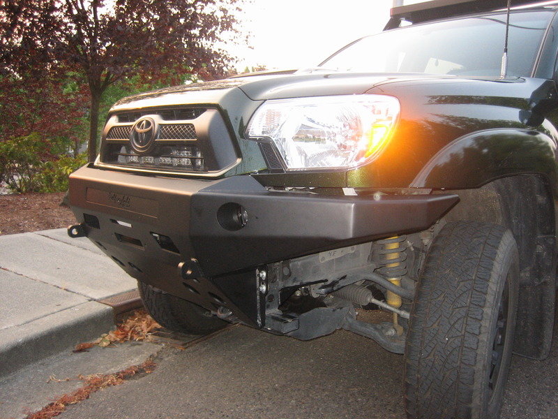

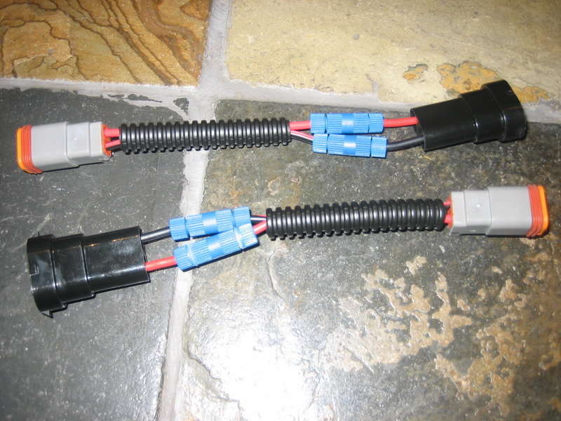

  12. Aug 27, 2015 at 8:28 PM
    #4312
    Denk
    Denk Well-Known Member
    Oct 11, 2012
    #88739
    1,185
    PNW
    '13 Spruce TRD Sport DCSB
    my take on hooking up RI D2s to the stock wiring. Later on I'll make a better pair without the splice.
    ...aaand a not too terrible pic of the final product. :cheers:
    Maximus, ERMB and Dr. Jekyll like this.
  13. Aug 27, 2015 at 8:33 PM
    #4313
    RearViewMirror
    RearViewMirror Saw things so much clearer once you... were in my
    Apr 13, 2013
    #102010
    24,080
    Craig Christ
    State of Love and Trust
    2023 Subaru WRX GT Manual
    You didn't even have to splice the wires. All you have to do is cut about 1/4" off the connector coming off the D2 and it plugs directly into the factory plug. You made a good looking harness though.
    Oh yeah... Awesome bumper :woot:
  14. Aug 27, 2015 at 8:39 PM
    #4314
    Denk
    Oct 11, 2012
    #88739
    1,185
    PNW
    Thnx. Cutting the plugs was the original plan but I ultimately didn't like the idea of ill-fitting plugs and bundling up in tape. besides, half the fun is working the problem and coming up with a solution.
  15. Aug 27, 2015 at 8:44 PM
    #4315
    RearViewMirror
    Apr 13, 2013
    #102010
    24,080
    Craig Christ
    Yeah that was the downside to me also. I thought about getting some shrink tubing to go over it but the difference in plug size is too big. Yours definitely looks better.
