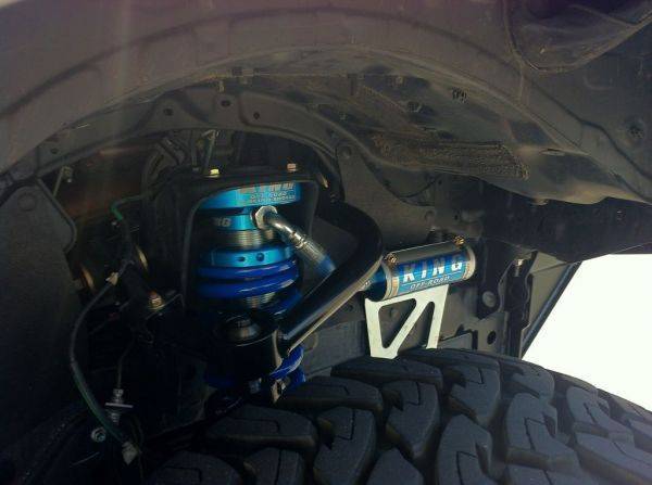

    Yup, C/O's are Coilovers. Good set of C/O' with min 650# springs are the cure for beefy bumpers

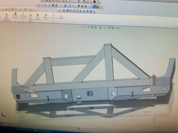

    Hmmm, starting to look like something. Probably start cutting some mock up pieces in the next few days

    Looks awesome! Have you run any Solidworks load simulations? What do you expect the gates load capacity is?
  16. Sep 12, 2012 at 2:38 PM
    #496
    Socalduckslayer
    Socalduckslayer [OP] Pelfreybilt Off-Road
    Feb 13, 2012
    #72745
    6,042
    Tyler
    San Diego, Ca
    12 Tacoma
    Odds and Ends
    No, havent tried any of that, still putting it all together. Its going to be way more than enough though so I'm not concerned. Load will be supported on latch side while in motion so its not super critical. Pivot is 1.5" chromolloy with ball bearings so its more than enough for anything you could ever want to put on there

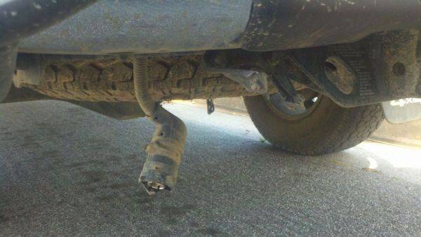

    SWEET!! You gunna be working it in with the OEM trailer hitch?

    No way!!! That thing hangs lower than an old mans balls (sorry Erik) :D Look at your stock one and tell me its not all beat to shit. The hitch will be behind the fold down license plate. Max clearance and departure angle is key

    I see you have the Hi-Lift points out near the ends, perhaps moving them in closer to the frame and mounting area?
