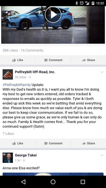

    From another thread but figured I would help spread the word.

    Won't see any other company post something like that, just another reason why they are the best

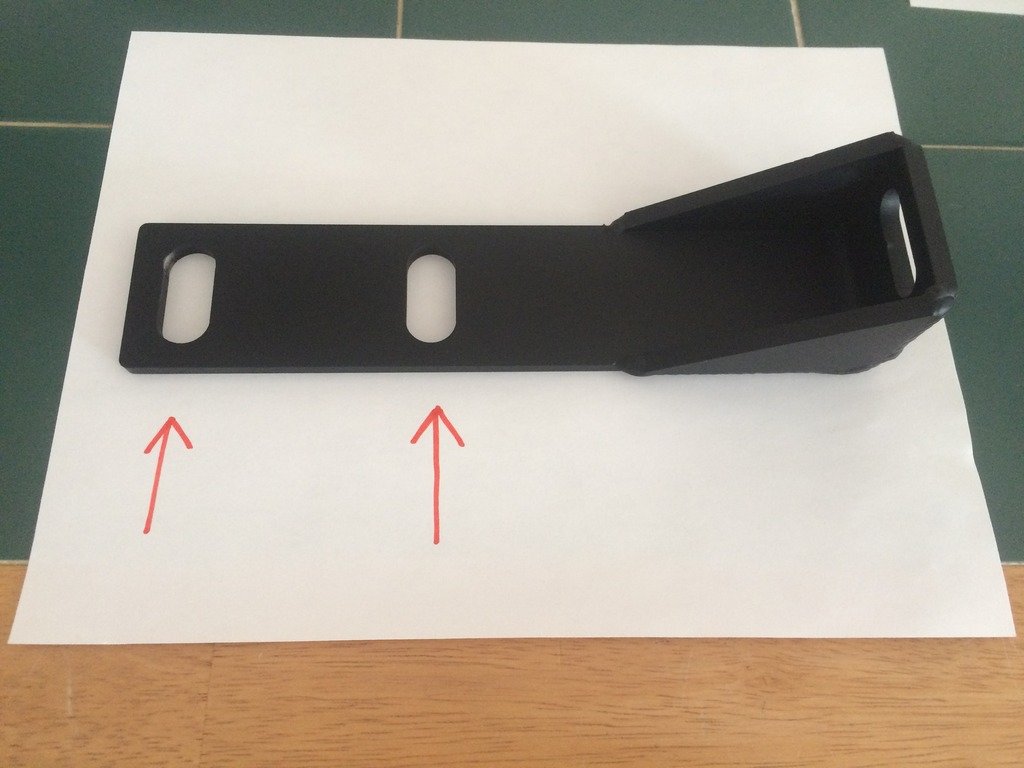

    Does anyone know what size bolts are used with this support bracket of the front bumper?

    Pretty sure your sway bar bolts are used there.

    I'll be of no help to you because I just reused my swaybar bracket bolts. Hopefully someone can chime in that actually knows what size they are.

    You reuse the swaybar bracket bolts. The long bolt that is running horizontally is included with your bumper.

    Ahh thanx guys! I totaled blanked on the sway bar since its been off so long. I'm thinking were they suppose to be supplied or did I remove something since the tapped holes were there. Will try to go threw the nuts and bolts I've saved from all the removals.

    Just measured one and it looks to be a M8

    M8x1.25 and prolly a 40 or 50 in length.
