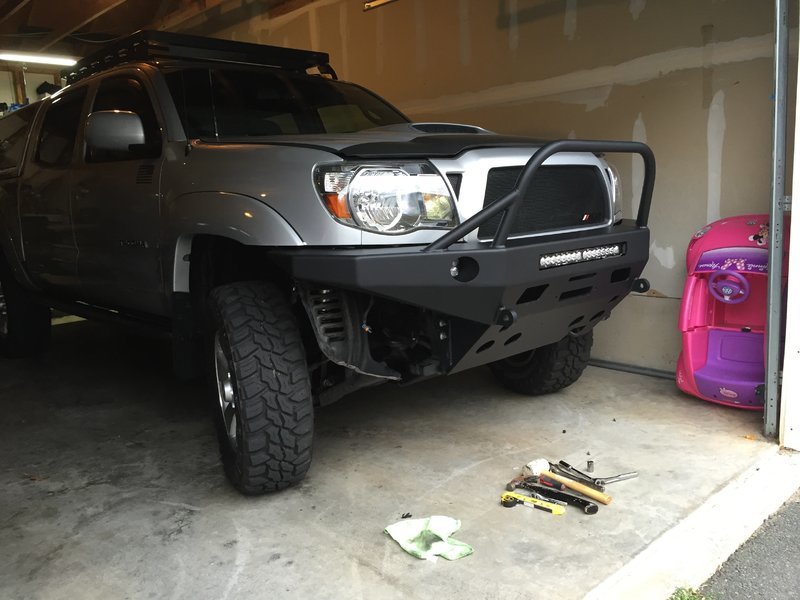

    Almost done with the install, is the front supposed to be level? If I stick a level on the top flat part it's tilted down, but it's straight inline with the fender and headlight line, I tried to shim it level but then it wasn't in a straight line with the fender and headlight line, if that makes sense

    IMO, it's better that it lines up with your body and fender lines. I doubt its supposed to be level anyways. Plus, you have no idea how "level" your truck actually is.

    Don't even use a level. Measure distance between bumper and headlights/fenders. Adjust as needed.

    Your bumper may be installed too high. There should be about 1/2"-3/4" clearance between the bumper and the grille/body panels. The bumper is mounted to the frame, and the body is on rubber bushings which allows it to flex. Could be that the body is moving juuuust enough to allow the grille to contact the bumper and pop those pieces out. If not, the retaining clips could be busted but if both are doing it, and they are fully seated, I'd look at bumper height.
