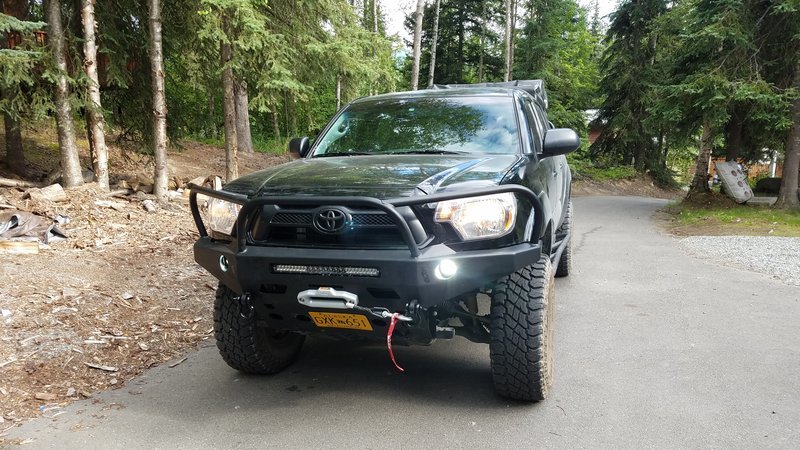

    No worries I hit it with some Satin Black! I mean the thing made it up to Alaska intact so that's impressive enough lol

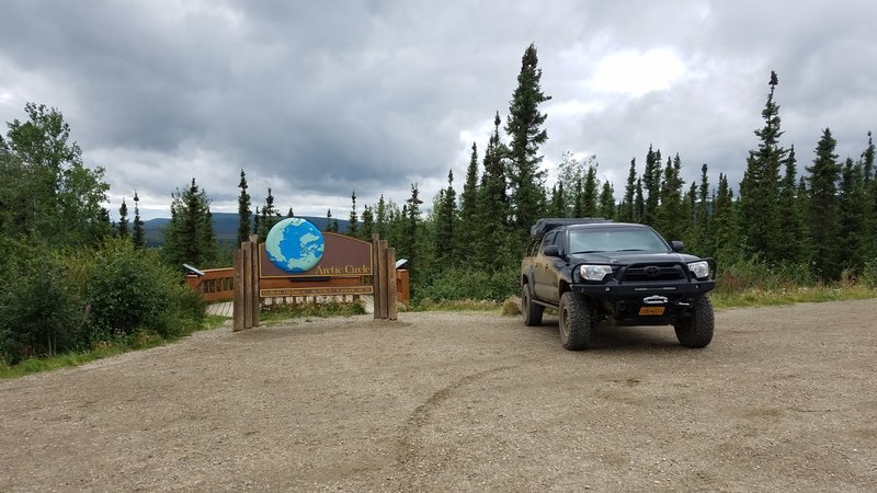

    Pelfreybilt crosses the Arctic Circle

    That's awesome, I need to get back up there. Nothing like fishing at 2am, grey-light. Most beautiful part of the country, hands down

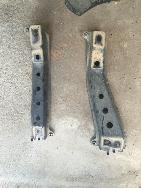

    @Socalduckslayer or anyone else with the pelfrey IFS skid, can you confirm it is necessary to remove the metal supports which hold on the stock skid plate/splash guard on a '13 TRDOR to install the pelfrey skid?

    Yes remove them. Keep the big bolts though
