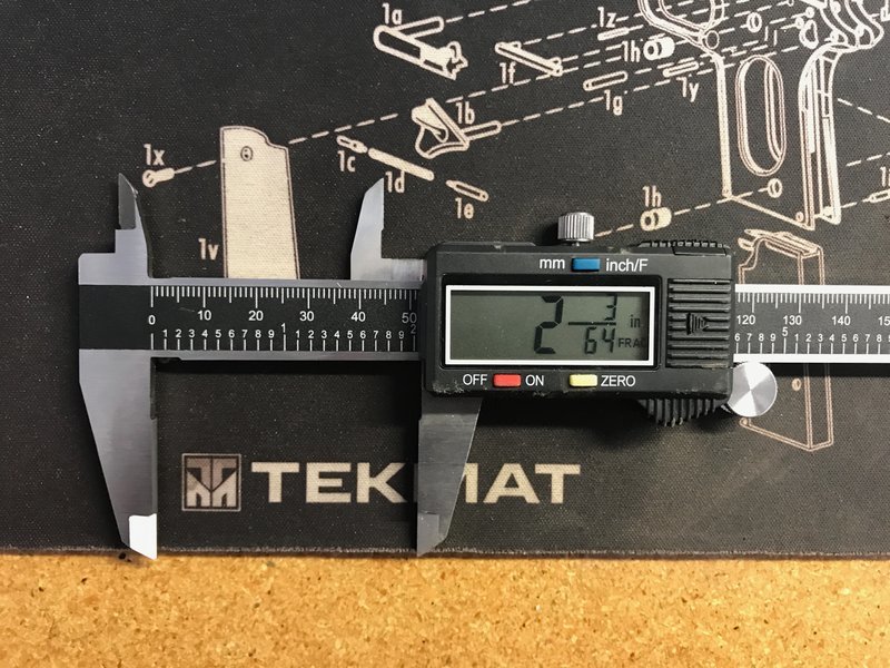

    So i've been filing and grinding and dremeling for 40 minutes now. The tow hitch thing wont even go in 1/8".
    First photo shows both hitch inserts. The one on the left is the one I bought, hoping i would be able to make it fit before tomorrow morning. The one on the left is my buddy's. Both of them are just a hair under 2". I worked through 4 dremel coarse sanding thingies, and worked that shit with a metal file too.
    Neither of these 2 bike mounts would go in even a tiny bit. Last photo shows how much it went in....

    I measured the tube with the digital caliper. Exactly 2", but I think the heat from the welding torch may have deformed the end of the pipe or something? I just wish I had appropriate tools to grind that shit down by brute force. I now have 2" square whole standing between me and a dirt bike I got free from a co-worker. I have to drive up to SF anyway but, I guess, I am coming back without the bike and just paying someone to ship it down. Taking the shell off is also not an option. I got my RTT on it, and I will be using it this weekend.

    I went out and measured mine for you. It is 2.0415 for the receiver, and the hitch is 2.0040. Bumper has powder coat and hitch has fresh paint from when I welded on a longer shaft to clear the license plate when towing.
    Will a regular tow hitch go into the receiver? Now I see the response with no. Take the regular hitch and make a mark maybe 3/8 to 1/2" from the end. IF.... you have a tree you can hook to, take a hammer to try and whack it in NO DEEPER than your mark. Yank it out to inspect for fresh marks showing where it is getting held up. Add a very light coat of paint to the end with mark if you have it to make it easier to see where it is hitting for sure before hammering in if you have it. Paint pen will also work.
    Try sanding/ grinding and inch or so on the little ridge inside the receiver that runs the length (front to back). Then see if it will go in a little. If so, then that is the issue and what my first thought of it being with my response earlier. Good luck and hope you can get your bike.

    We have seen these hitch tubes run on the tight side before, not often but every now and then. As long as you measure side to side, top to bottom it should be over 2", not by much but still clear.
    The issue we see most often is the corner radii. The receiver tube is a national standard so it never changes. The hitch inserts sometimes have a very thin wall which translates to a sharper corner radius that will interfere with the receiver tube. Add powdercoat etc and they can get tight pretty quick. I'm guessing the corners are the issue here, the one other time we saw this was exactly that, just a tight corner on a thin wall hitch insert.
