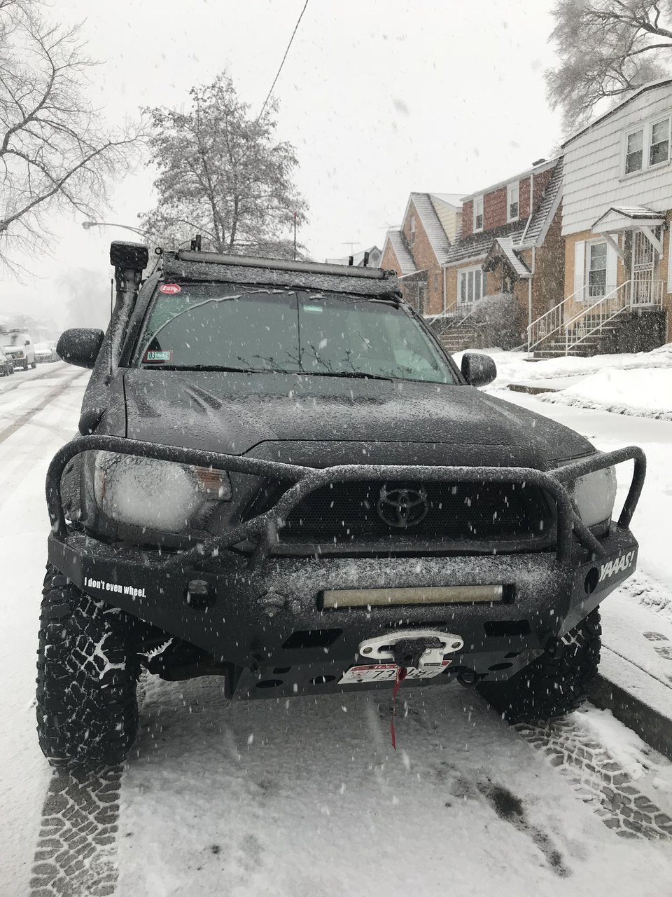

    2GMGMDCSB4WDTRDFTMFW!! TL;DR
    mostly stock, grocery gettin' Prius
    Loving the new face lift!!!!!
