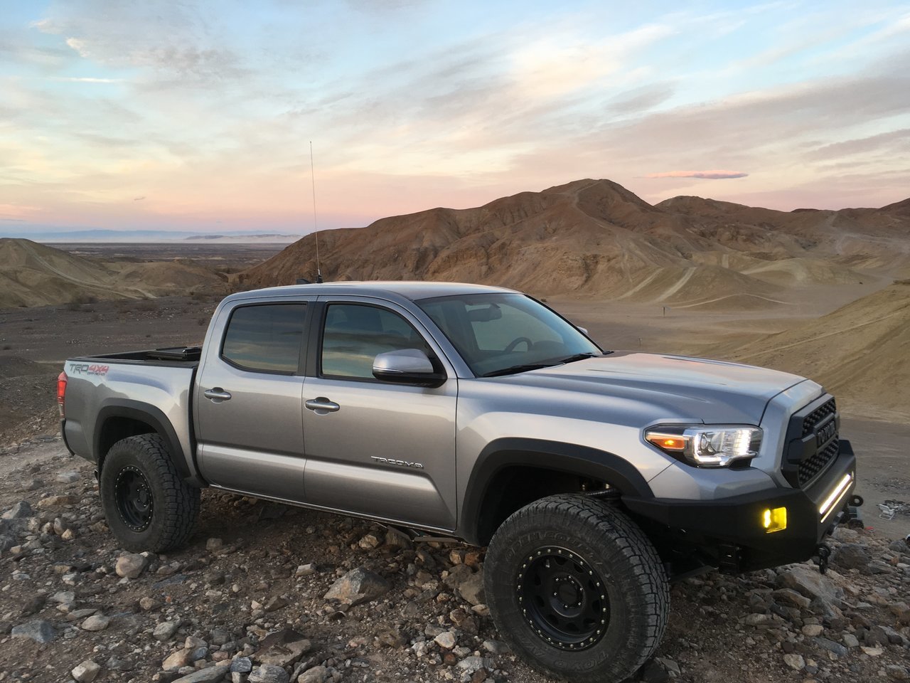

    Both look great! Here is @h5863emtmatt rocking our Tacoma Aluminum Front Bumper without hoops.
    2016-2018 Tacoma, Aluminum Plate Bumper - starting at $1299
    http://www.pelfreybilt.com/product/2016-2017-toyota-tacoma-aluminum-front-plate-bumper/
    Rocking the Center Hoop or 3 Hoop will give you added protection which is certainly beneficial if you live in an area with wildlife that could enter the roadway. A lot comes down to personal preference as well. Here is @shawn_free with the Single Hoop

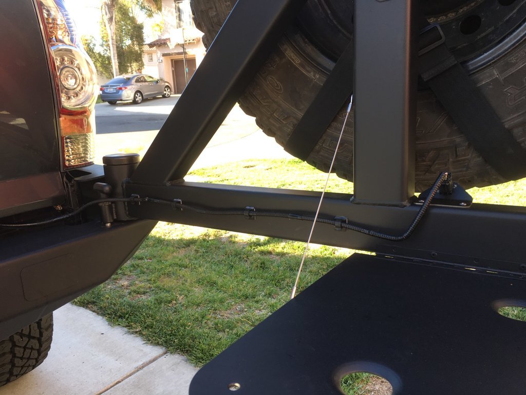

    Question for those with swingout rear bumpers; How do you extend the rear camera? Splice in wires and make your own harness? How long does it need to be? Do you drill holes into the top bar of the swingout and rivet the camera bracket to that bar?
    My brother received the actual install instructions from Pelfreybilt with his bumper and it doesn't mention what to do at all. Any information would great help and TIA

    This fella sliced in 20ga wires, I'm curious myself if there's an easier way.
    https://www.tacomaworld.com/threads/diy-back-up-camera-relocate-with-spare-tire-swingout.491245/
    Found another, looks like splicing is the way.
    https://www.tacomaworld.com/threads/anyone-relocate-the-reverse-camera-for-a-tire-swinger.351858/

    Cut the connector off (allowing enough wire to comfortably extend it), add in needed amount of wire, mount, and adjust to match the proximity lines. Pretty simple TBH. Made the bracket out of some scrap Al.

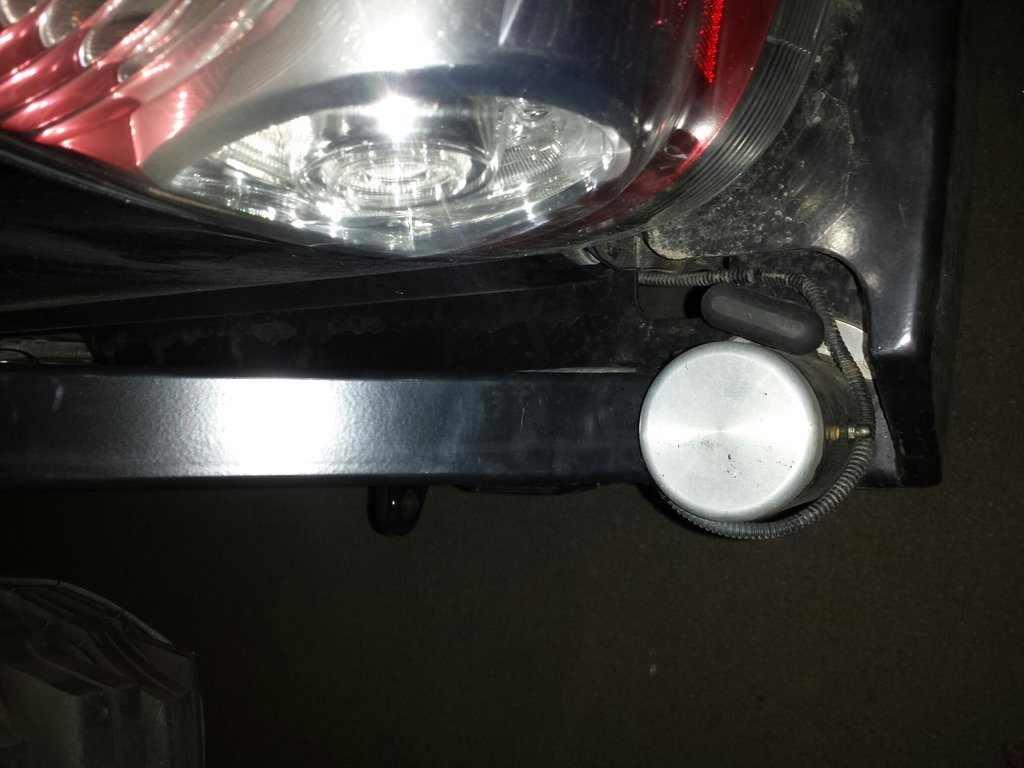

    I took the OEM mount loose from the frame and that gave me about four more inches of cable to play with. Here's what I ended up with. I'm still tweaking it to avoid the cable hanging up but it seems to be working.

    Wrap the wire around the outside of the spindle housing and then bring it back in. The "service loop" works well and gets tucked away inside the cutout in the bumper for the rear fender
    EDIT: Something like this. Has worked well for me. Keeps the wire clear of the pull pin when open as well

    I believe the setscrew hits that groove.

    I was scratching my ass trying to figure it out as well. My o-ring slid up to the top of the cap so I just lubed it up and pressed down as I tightened up the set screw. Not sure if that's the right thing or not.

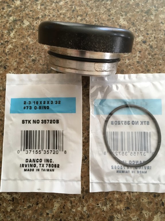

    Sorry about the issue. The O-ring should seat into that groove. The fit is very tight and may require some lubrication on the outer ring. Sometimes turning the cap while pressing down helps prevent the ring from popping out as easily.

    @itaro @Pelfreybilt I went to Ace and bought a bit smaller o-ring that fit in the groove better but it was still a cast iron bitch to fit in there.
    After screwing with it for a while I noticed that just above the upper bearing race there's a machined groove. Sure enough the supplied o-ring popped right in there. I packed it full of grease and the cap seated perfectly right in there. It's in the hole....

    I only used the one supplied o-ring in the "factory" groove. I packed it with enough "boy butter" that it's fine. I even hogged out the groove in the cap with jewelers files but that second o-ring wanted no part of going in.
