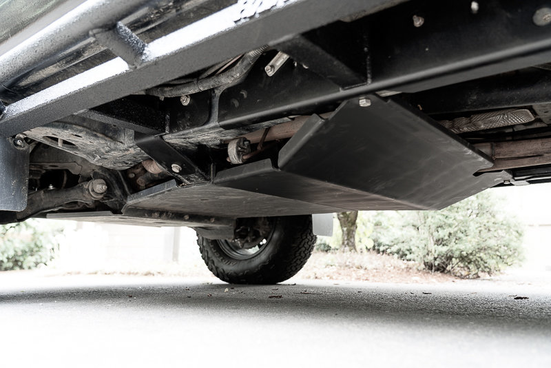

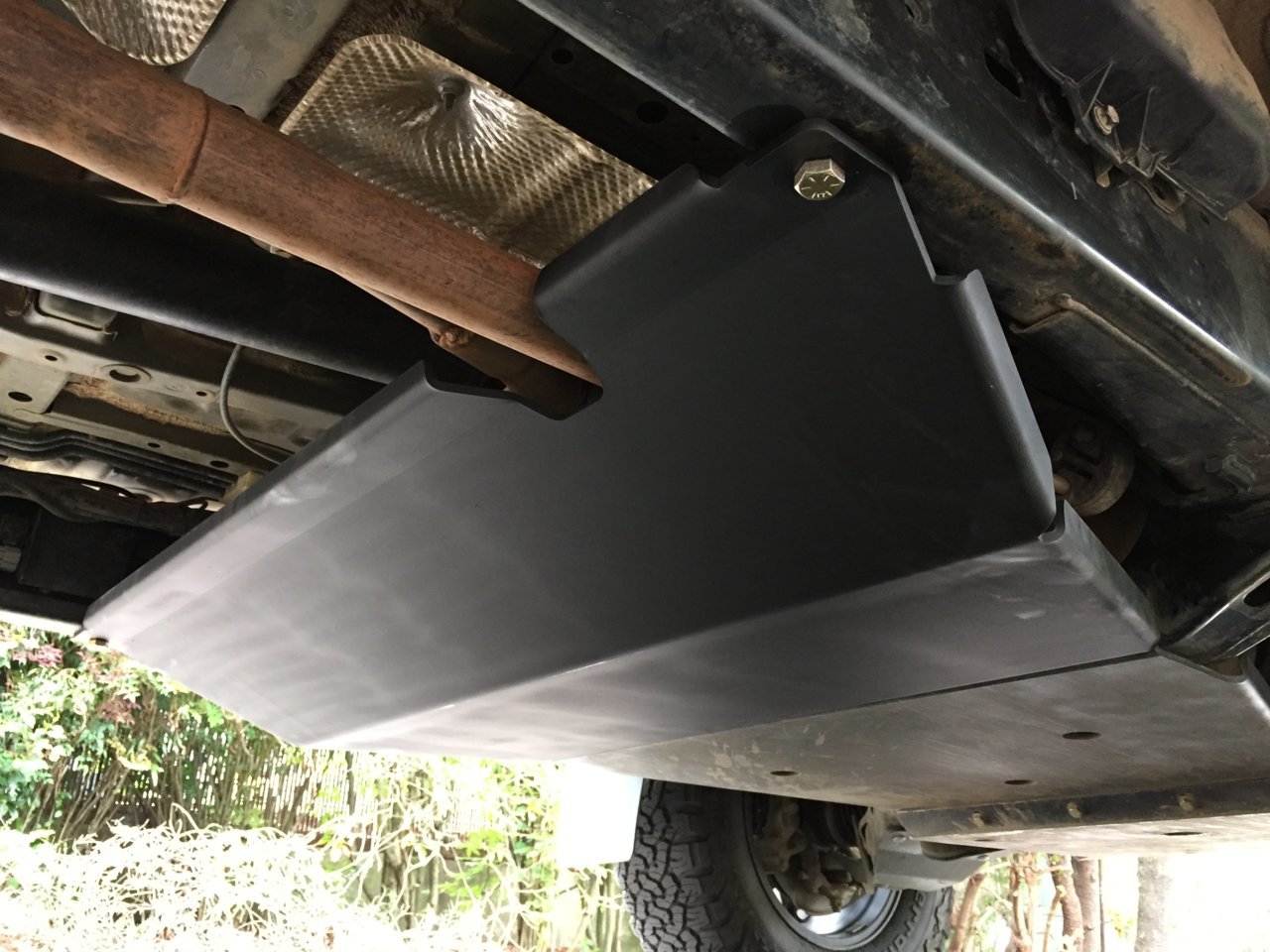

    Just installed mine (finally). It attaches to the mid skid and the frame.

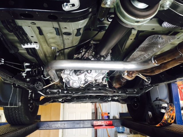

    Awesome- is there anyway it won’t fit if I get the exhaust reroute done as basic as possible?
    Showing the guy this picture

    That re-route should work. That's how mine was done. Plenty of clearance.

    @Pelfreybilt i have allpro rock sliders and I want to get the steel reroute skid plate but I the picture above I see it bolts onto the frame same ass my sliders. I need help

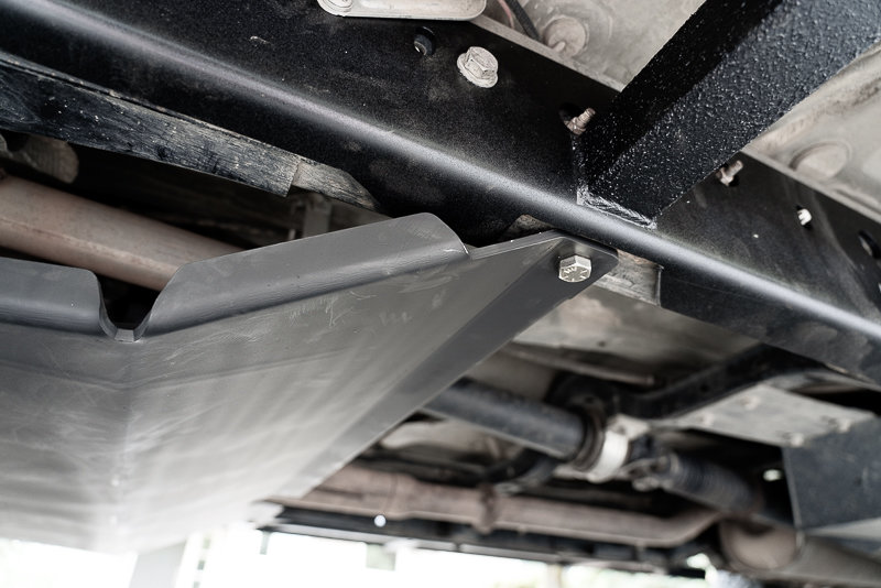

    Update: Sliders notched for the rear skid to mount flush to frame. (Sliders are not Pelfrey.) :thumbsup:

    Seems like all the help was provided! You would have to remove the sliders most likely and notch them for the skid, we dont take other brands of armor into consideration when building ours! Glad to see you guys all made it work!
