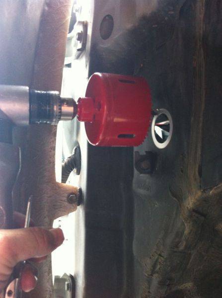

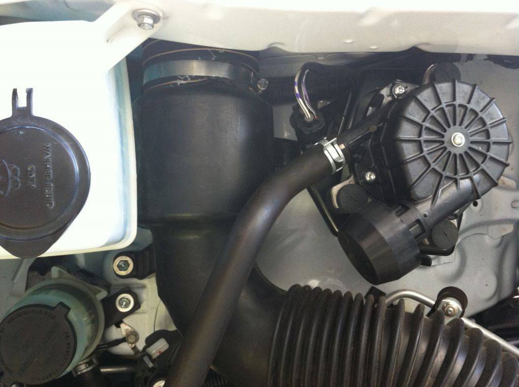

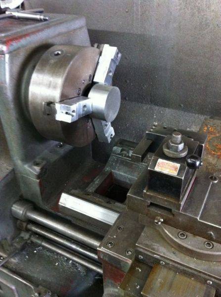

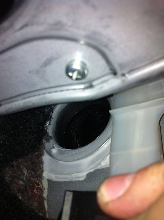

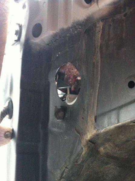

    Resolved the water, dirt and mud concerns into the intake today. After replacing fenders it leaves the intake scoop pretty vulnerable. Since a snorkel is not a great option with glass fenders why not try something else. Big thanks to Wicked 2007 for the layout.
    First, turned up a reducer with a collar that could be clamped into the wheel well
    Then knock a 3" hole thru the cab where the antenna was, carefully to not mess up anything on the inside. Also need to cut away a bit of carpet and insulation on the inside
    Slide 3" flange adapter into hole with generous sealant and rivet into place
    4" Aircraft ducting around the factory intake scoop and hose clamp around intake tube
    Attach 4" ducting to reducer and then 3" ducting to reducer and into 3" flange adapter. Clamp down and done.
