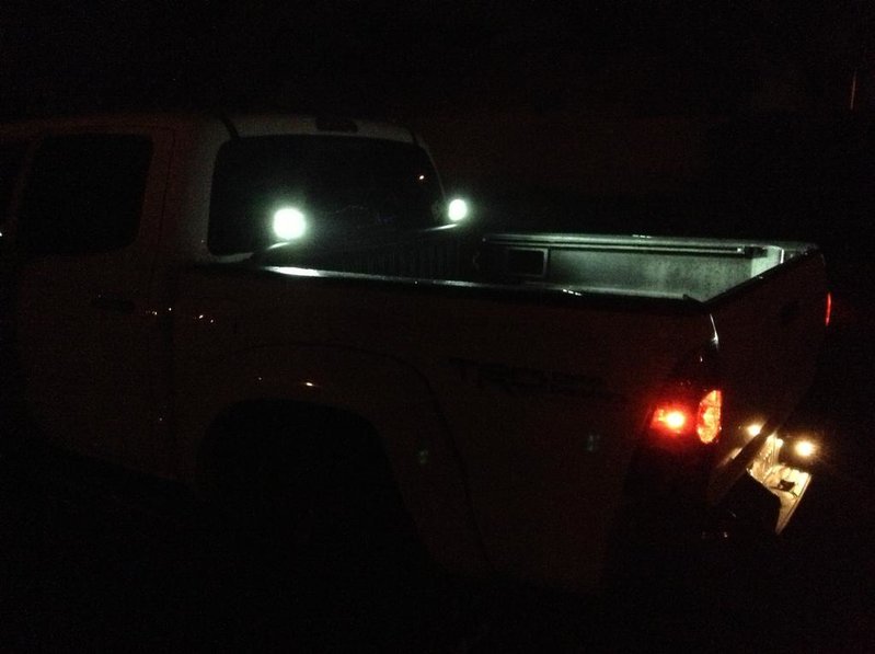

    I love the bed mounted light bar I purchased! Here is a pic of my lights at night. Thanks, Tyler.

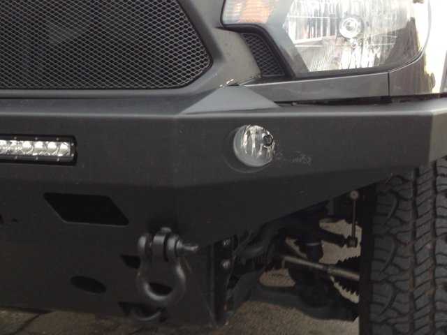

    also finally added my stock fog lights to the PB bumper

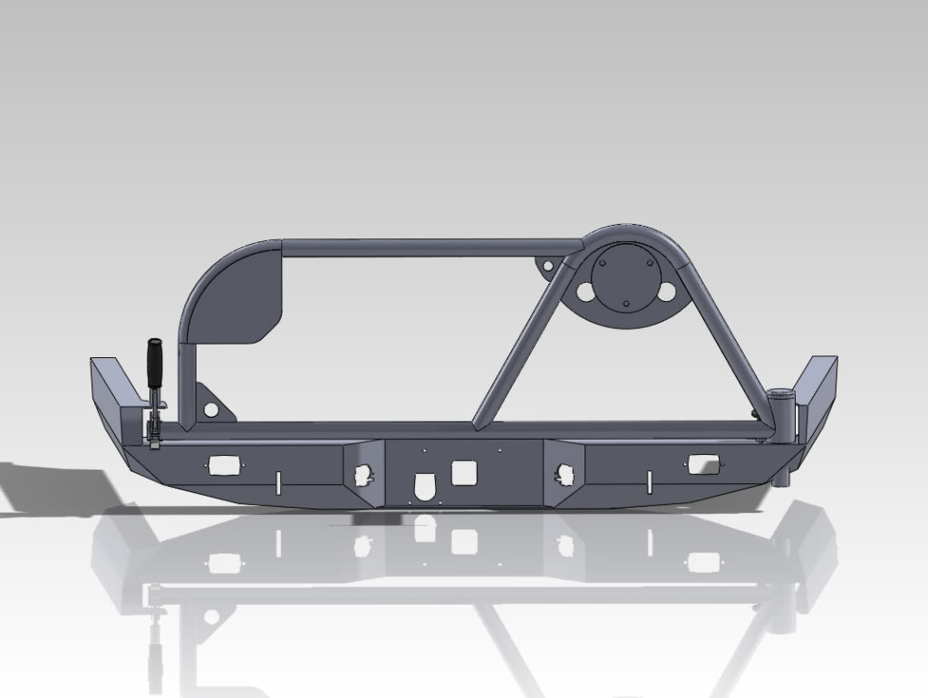

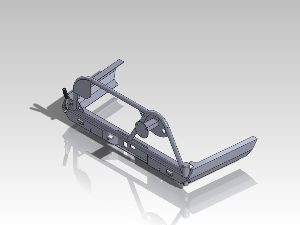

    So to give you an idea of the changes in the rear. Its mostly in the outer corners. I brought them in tighter and cut the corners a bit. The original design was nice but I did notice those corners grabbing a little dirt from time to time. The reason they were that way was to allow for a hi-lift mounting point, the shackles work just fine for that so eliminated them. The lower end of the sides are just a touch higher as well. The spindle on the swing out is larger and has a zerk fitting as well. The main thing is the latch. I originally went with the de-sta-co pull latch thats so popular but I dont trust it so I have now gone with the Synergy suspension fail safe latch, more money but much better design. Here are a couple shots of what the basic design will look like. The spindle still needs to be trimmed, its drawn to scale so disregard how it protrudes thru the bottom.

    Wow nice Tyler!! You never fail to impress!

    wow Tyler that looks great, PM incoming :D

    Looks like your putting in quite a bit of behind the scenes time man! Can't wait to build one of these things!
    Impressive to say the least.
