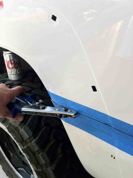

    Since the bed sides have to be cut anyway, you could do some practice runs BELOW the actual cut off line just to get a feel for it. Use a couple of layers of masking tape too.

    Making a practice lower cut sound like a good idea. I have a dremel type tool with good cutting discs, or a bigger 4.5" angle grinder with thin cutting discs. Thinking the little "dremel type" might be best because it can be precicely controlled (once I determine where the cut needs to be).
    On the MASKING TAPE: Do you cut through the masking tape or along the edge of the tape?

    ^ Cut through the tape. It helps to keep the paint down so it doesn't chip or peel when cutting. I would also use more than 1 layer of tape.
    The first cut is always the hardest, after that, you kinda want to cut more stuff up on the truck! :)

    I use the blue tape and a hand shear, it cuts slow but controlled and accurate. Small imperfections are hidden by the rubber trim I provide with the bumper. I use a cutoff wheel in the lower rear corners where it's double thick and coutoured. Also on the flare.

    I like that hand shear, does Eastwood sell that tool? A garage full of tools and still need more....

    Feb 13, 2012
    #72745
    6,042
    Tyler
    San Diego, Ca
    12 Tacoma
    Odds and Ends

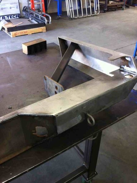

    do you have any pics of the rear high clearance bumper on the floor, not installed? A co worker asked me how the sides are supported from caving in. I said I didn't know but I would find out

    Socalduckslayer [OP] Pelfreybilt Off-Road
    Feb 13, 2012
    #72745
    6,042
    Tyler
    San Diego, Ca
    12 Tacoma
    Odds and Ends
  20. Aug 14, 2013 at 11:11 AM
    #1820
    Mossy
    Mossy Mechanic for Honda
    Dec 31, 2012
    #94122
    580
    billy
    san antonio, TX
    ProComp lift Borla exhaust Borla air filter Nfab bars
    Awesome! Thanks man!
