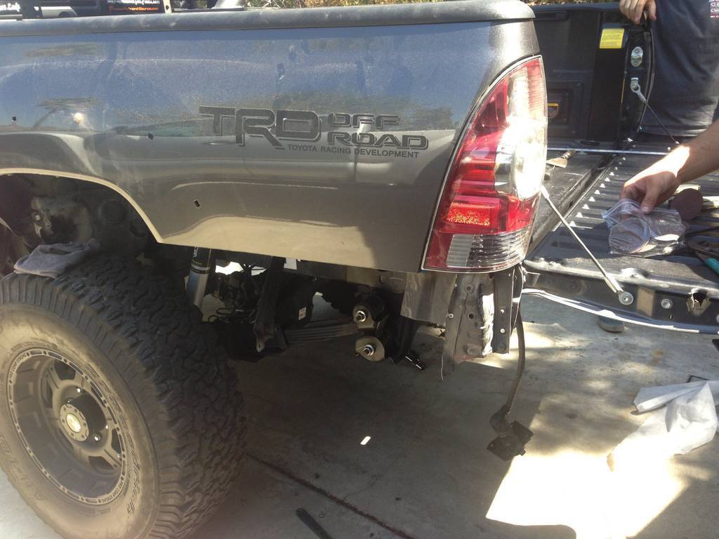

    Airdog: Very Nice rear bumper there! You did a superb installation. Are tere any tips you can offer for installation of this HC rear bumper? I have one ready to come to me and I am anxious to swap out the rear stock bumper.

    #93790
    4,902
    Tom
    SoCal
    https://www.tacomaworld.com/threads/airdogs-2012-prerunner-access-cab-slow-build.264263/
    Measure multiple times. I used two 3 foot straight edge rulers to make my measurements before cutting. One off the top of the bed to give me a place to measure down to the cut line. After I measured down from the top of the bed I taped the straight edge along my cut line and used it as a guide for my cut off wheel (kind of like a fence on a table saw.) If you are using a cutoff wheel for the whole cut go slow and let the wheel do the work. It keeps it from heating up the metal too much and possibly bubbling the paint. Here is a shot of my first and only cut:
    I got lucky and was satisfied with the gap between the bumper and the bedside after my first cut. The instructions have a couple of measurements as a guide. It seems as if every truck is different as I actually made my first cut about 1/2 inch longer than suggested in the instructions. My suggestion is to make sure the first cut is about 1/2 inch below the bottom of the tail light. On my truck it was 17.5 inches and it worked out for me. I think this number may change from truck to truck depending on how the bed protector is sitting on the top of your bed. Big thing to remember is you can always trim it shorter but you cant put back what you cut off.....so play it safe and take your time.

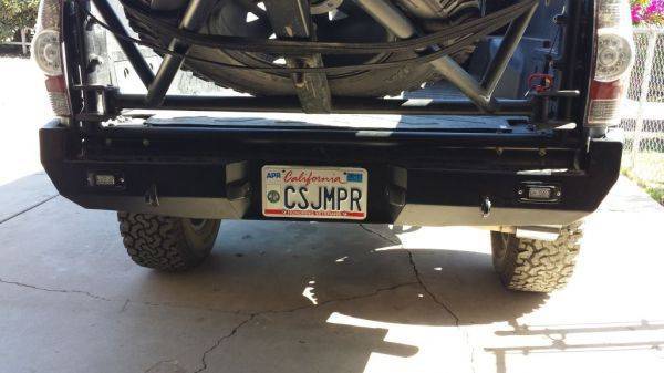

    Apr 8, 2011
    #54596
    5,400
    Savannah, GA
    2014 SSM Trd Off Road 4x4 Auto
    Ok finally got the rigid flush mounts installed. Look awesome
    check it out

    bullaculla
    bullaculla IKA fabrications
    Oct 14, 2012
    #89002
    8,155
    Da big big island!
    2013 MGM DCSB Tacoma 4X4 TRD Off Road
    All pro 3 link SAS kit, Diamond axle, kings on 37" MTR/K
    They. Are awesome. And crazy bright!!! Like having headlights in the back :D
