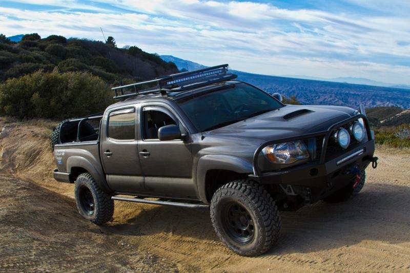

    This product is just as sturdy as the rest of Tyler's products. You can tell that he definitely put research into the mounting points of the rack. The mounts didn't touch the roof at all, however drilling through the rubber of the weather rails was a pain in the butt. Much as Tyler said it would be. I installed it myself which was definitely handy. Tyler can make any 40" light bar mount to the rack as long as you give him dimensions or let him use the bar to mock up the tabs. You have the option to include a NMO mount and a CB mount tab on the roof rack which I decided to include. I also added the polycarbonate wind deflector to my rack.

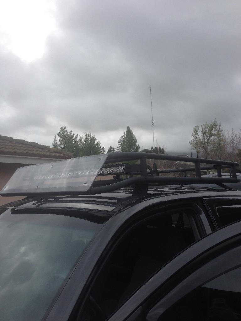

    I had to dremel out the NMO tab a little in order to fit my NMO mount into it, but thats a small fitament issue that comes along with any custom piece. When you are installing the wind deflector I highly recommend getting some foam/rubber stripping to place against the portions of the deflector that touch metal at all. I failed to do this when I first installed it and it vibrated so much that it sounded like my truck was a jet plane trying to take off.
    In my opinion I think you can put a thinner wind deflector on there because it affects light output of the LED bar placed behind it. On a positive note of the LED bar on the rack. If you have a sport you might have mild hood reflection that will affect you(barely due to the hood scoop) and if you have lack the hood scoop, I don't believe it will really affect you. So the bar being recessed back takes off some of the typical reflection you will come across.
    I really liked the design of the mounting points to the roof and the rack itself. They are sturdy and make aligning the roof bar a breeze. They also make it so you can place the rack on to the roof alone with some strength and careful placement ( not my fault if you drop it on your roof though :anonymous: ) from the bed of your truck.
    Tyler also keeps the design of the rack from affecting your satellite radio or GPS if you have it mounted which is great if you use it. I opted to never use mine again and use it as a way to run the wiring for my antennas and roof lights.

    - the wind deflector is slightly too thick, it definitely affects light output more then you would expect
