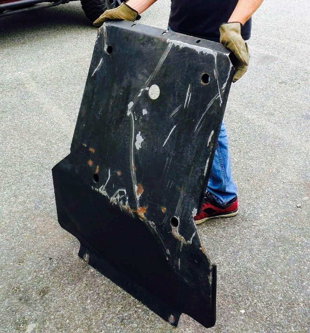

    Anyone know what the recommended torque specs are for @Pelfreybilt skids? I can't find any info on their site / FAQs and haven't been able to get a hold of them. Thanks in advance.

    We go off the OEM torque specs for our skid plates. It's 22ft/lbs for the front skid plate. Always tighten down the bolts evenly to ensure a flush fitment.
    -Pelfreybilt
