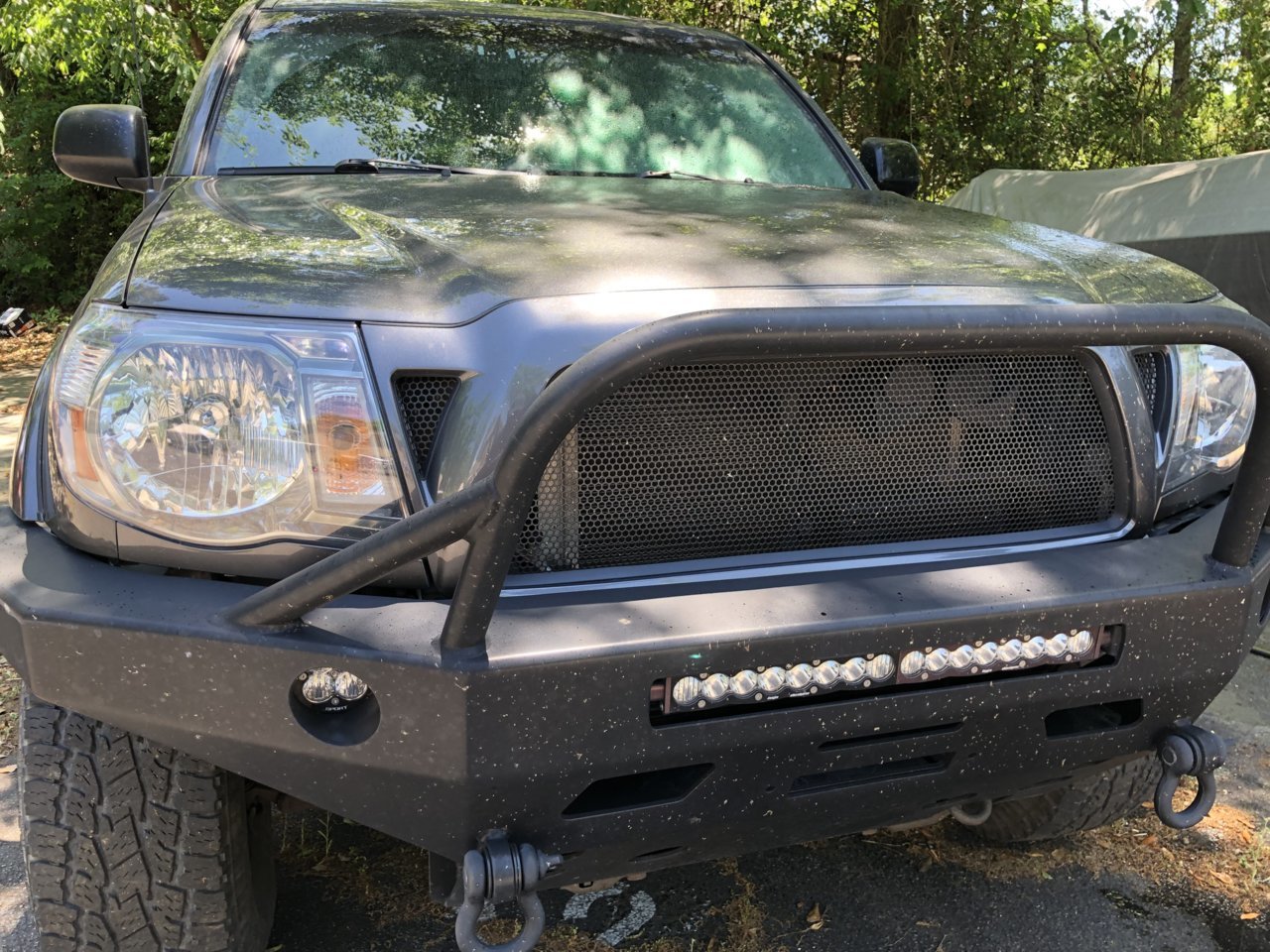

    54357854-6FB0-4C3A-B87D-8A5D1AD231D2.jpg Anyone have a Pelfreybuilt bumper in a state that requires a front license plate? I just moved to a state that requires a front plate and it appears there are two holes lower on the bumper for a license plate, but I don’t see any way to access the back of the holes to put nuts on the back of the bolts. It seems completely closed off like you would have to mount the plate from
    the back before putting the bumper on. I also think it’s kind of low and won’t display the plate very horizontally so I don’t want to attract attention from the man either.
    I don’t have a winch and don’t plan on getting one so the second option I thought of is just some straight brackets that would span the winch gap and run bolts through plate and brackets with lock nuts on the back. Looks like I can reach in some of the other cut outs to be able to do this, and plate would be more horizontal and higher on the bumper.
    Third option is to put top of plate just above winch cut out and drill two new holes and bolt it on.
    I have seen some threads that talked about a flip up bracket that mounts on Pelfreybuilt and other aftermarket front bumpers with two small bolt holes that would have to be drilled. I’d consider this if anyone has any experience with one, but all the links didn’t work since Pelfreybuilt is no longer.
    Any ideas appreciated!
    Thanks

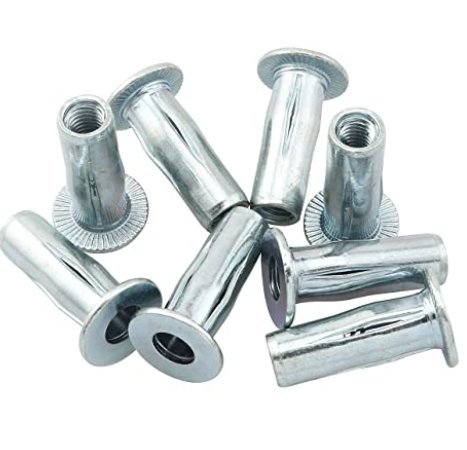

    You can use one of these to put nuts into the holes so you don't have to reach around the inside.

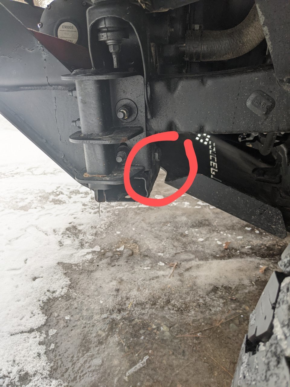

    Pelfreybuilt for my 2.5 gen, maybe it's a little different. There should be a space. I circled it here on mine. Should be a hole below the winch shelf. Reach around under the frame right there and you should be able to get in there. You really have to give your bumper a big ol bear hug to get it done.

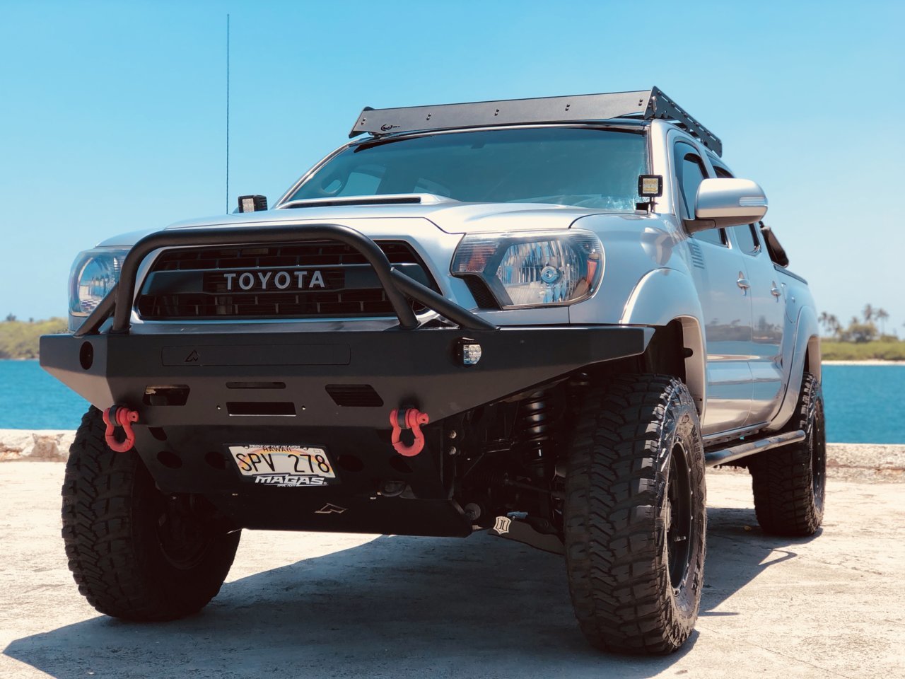

    6E2C2629-B5D4-4354-8ED3-9A33D06739FD.jpg I just used the holes provided for the license plate never had any issues with the law about it.

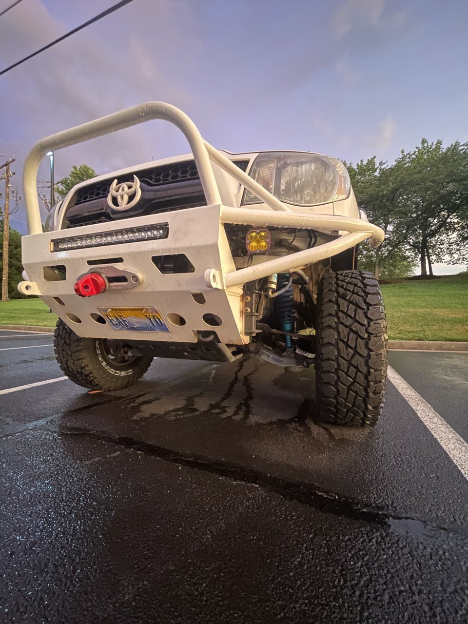

    There were holes in mine. Had to put my front plate on recently

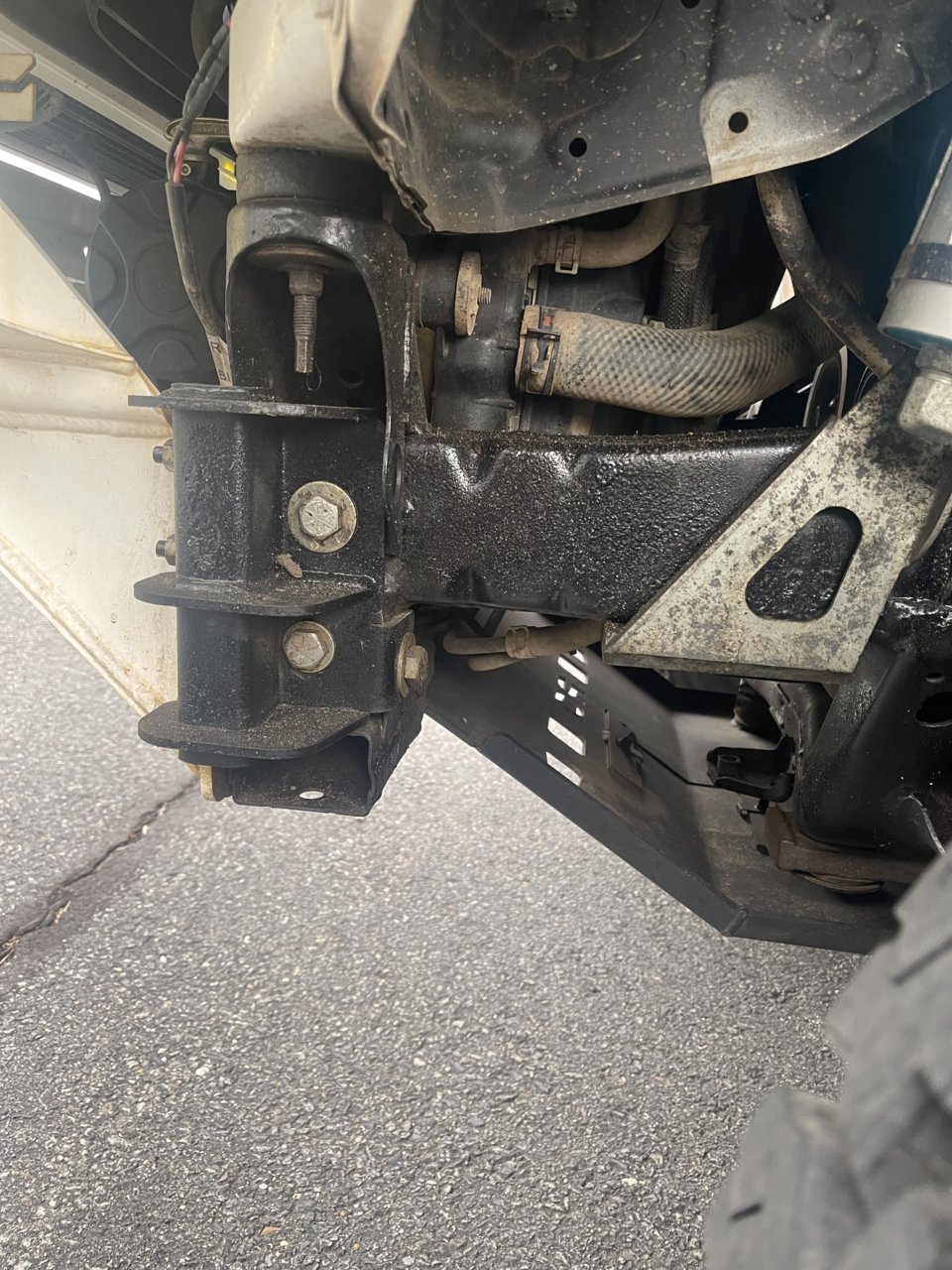

    In front of the LCA mount, above the skid plate theres a place to get your arm in. I put my bolts facing outside. But just gotta do one side at a time

    I tried reaching in there, but on my drivers side there are metal hose lines in there so I couldn’t get very far without getting hung up. Did you have to get by those hoses?
