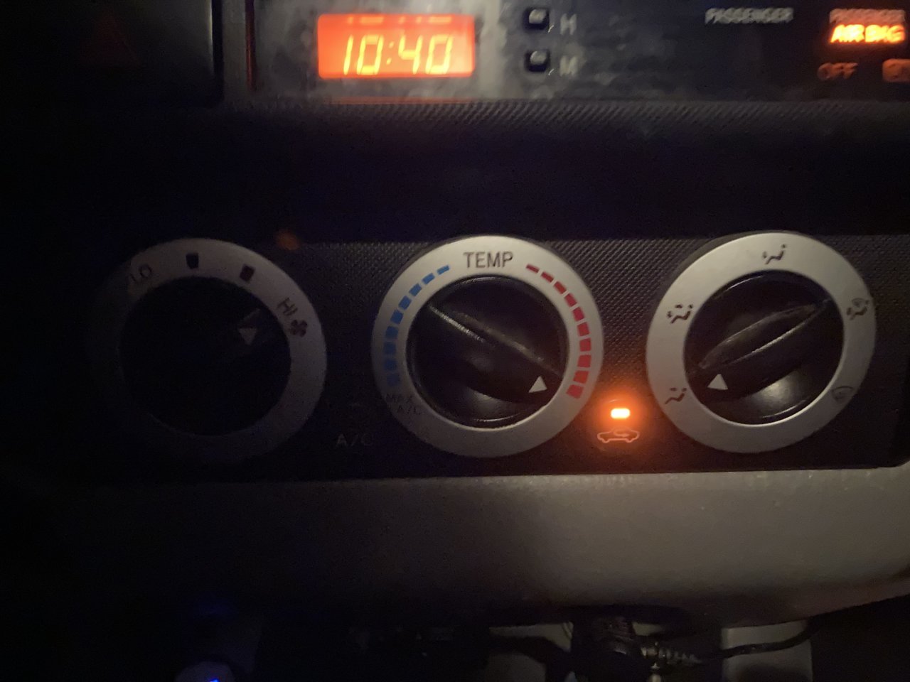

    On another note, recirc button on the HVAC controls always seems to be on when I restart the truck after it’s been sitting for a while.

    I would want to have the ABS codes read, it may be as simple as recalibrating the ABS ECU.
    The recirc should stay where you last had it unless you have your temp control set to max then it will force the recirc on at power up.

    Just went out to the truck and started it; Been sitting since a little after 9pm...

    Check it out, it was on heat...
