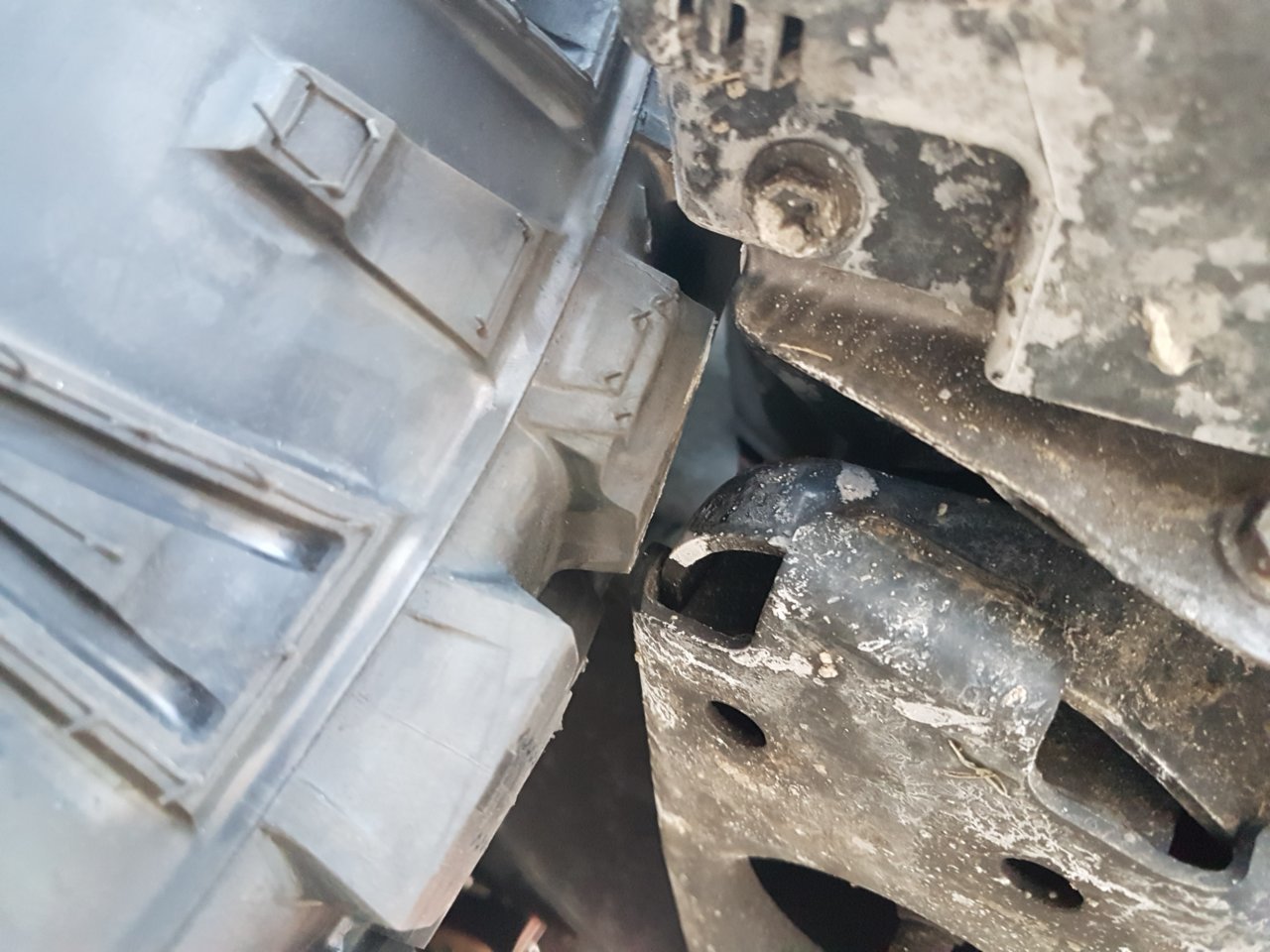

    NO RUB GOING FORWARD, SLIGHT UPPER CONTROLL ARM RUB IN REVERSE AT FULL LOCK, but I can live with it.
    Full lock is 1+3/4 turns from center. At 1+1/2 turns from center no contact.
    Rubs the edge of the tread block, not the sidewall. Will lessen as tire wears.
    Tested at full compression and extension UCA contact about the same.
    Slight rub rear lower fender flare with front Suspension fully compressed and turned. Trimmed plastic. No Cab Mount Contact. No rear tire contact.
    NOTE: The more you move the wheel out away from UCA, with spacers or more offset wheels, the more contact you will have with other parts, like cab mount.

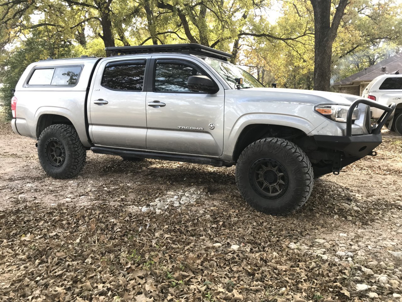

    I’m running 2” of lift on stock UCAs, with 16x8 0 offset and 285/75, I’ve had cooper stt pros and now another less aggressive hybrid tire. Never have I rubbed the cab mount, I rubbed other places but a heat gun took care of the small amount of plastic I would rub when I had stock front bumper. It’s all in the wheel specs, it’s been wheeled hard, stuffed and up on 3 wheels more than once so if it was going to rub It would have by now. Been running this set up for 40k miles.

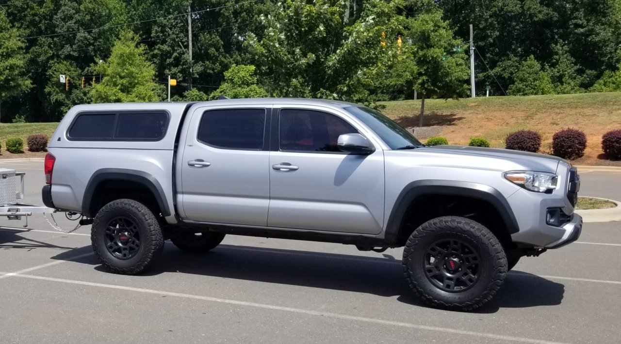

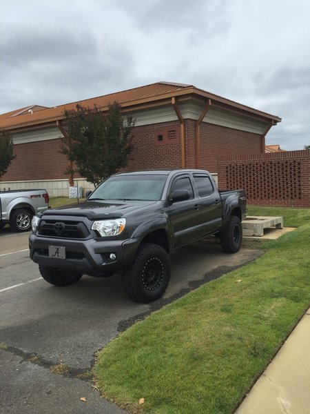

    I’m going through the same thoughts now as well. I’m ordering tires and wheels tomorrow. I’m getting method MR701 wheels which are a 16x8 0 offset with a 4.5 inch backspacing. I plan to lift mine two inches in the front and 1.5 in the rear to keep my cv angles good and to hopefully not have to do a diff drop (another confusing factor on deciding what to do). I know I can fit 265/75/16 with this setup on stock suspension so I’m not sure how it will be lifted but I don’t know that I want all the headaches that come with 285s on a new truck. Here are some photos of my 2015.... lifted 3 inches in both photos. Top photo is 265s and the second photo is 285s. (My current truck is a 2018 TRD OFF-ROAD DCSB)
    SandmanTRD and TacomaOC714 like this.
  14. Nov 25, 2018 at 7:01 PM
    Turd Hawg
    Turd Hawg Well-Known Member
    Jan 7, 2018
    #240541
    813
    2018 DC SB OR AT TT
    Should probably cut those ubolts a bit.
